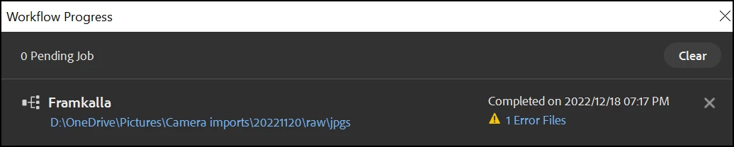

Bridge workflow not working
As soon as I start a simple little "save to jpeg" workflow, it gives med "1 error files" and when I open that row I get Reason: Destination Cannot Write and Task: Preprocessing.
No files are saved/converted. I have run workflows before. I have turned off Ransomeware Protection in Windows. No luck. I'm running Bridge 2023. I have write access to the folder, I usually choose to create a subfolder from the original location.
Any help would be much appreciated.

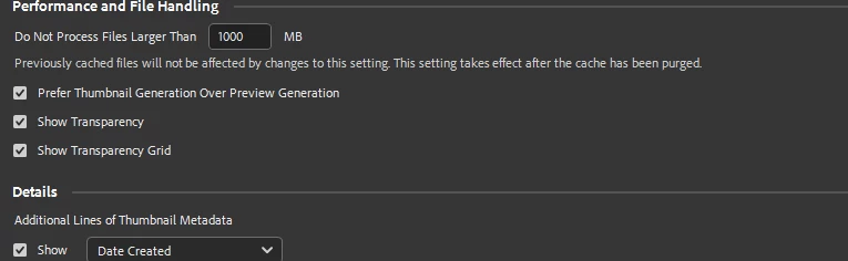

Not saying vthat it is related but I had trouble with exports in the past and it was due to the file handling preferences in Bridge (files too big)
You can also check the cache settings in the preferences as well, just in case.
It might not be it, but worth checking!
Dec 27, 2022 3:13 PM UTC
Bridge does not work with cloud services. Save to a folder that is not sync'd to OneDrive.
