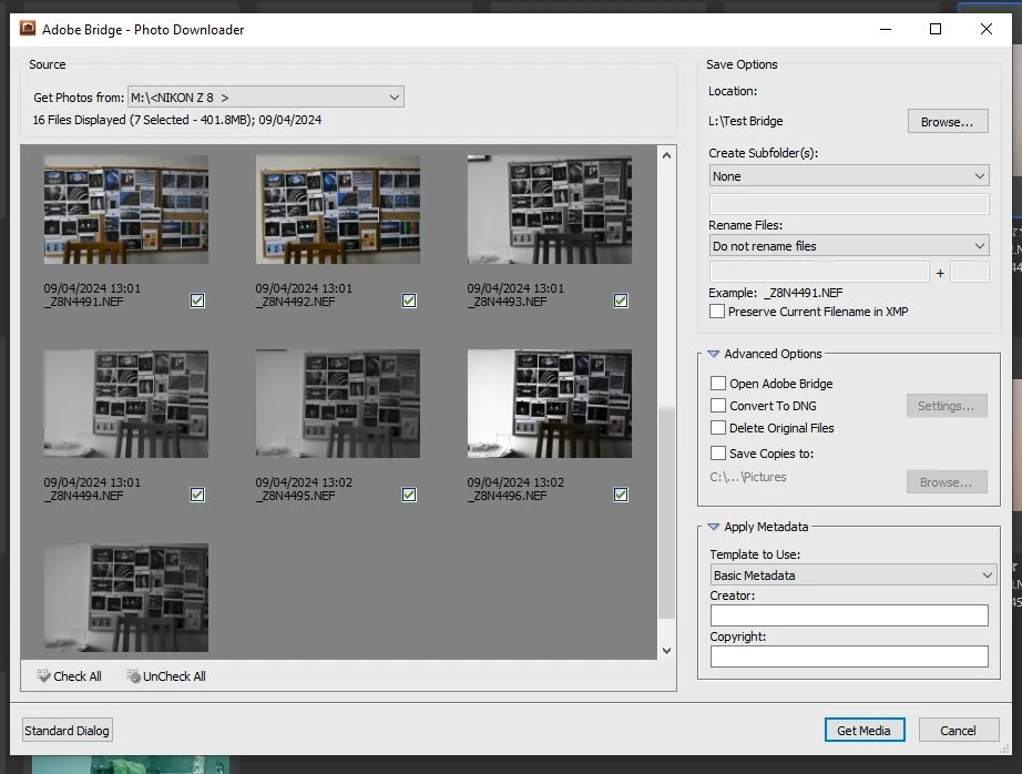

I have just started shooting RAW files with the mode set to monochrome
I have checked the camera settings option in Bridge/Camera Raw preferences.

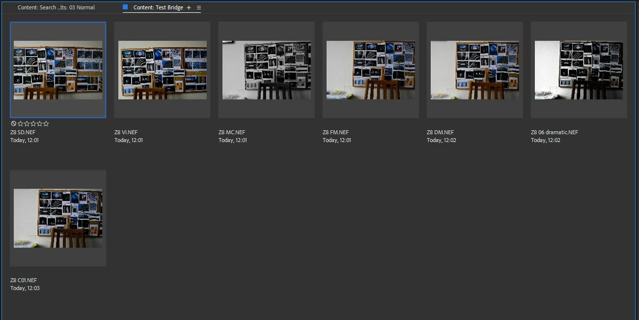

This works fione for my D500 but for the Z8 it starts off in mono as on the back of the camera, but then sets to colour (ie applies Adobe Defauilt. I have checked and ensured the switch is set and when I purge the cache it temporarily reverts to mono before reverting to adobe default.
Having done some more tests, it works for the Z8 on Monochrome (MC) and Dramatic (06) modes but not FM (Flat Monochrome), DM (Deep Monochrome) or my customs one C01 which is MC with 2 stops extra contrast).
I am now stuck.
If I set it to another preset it works well so I think it is what is being writton to the Z8 metadata. Is there a way of checking that the metadata created by Z8 is correct?
