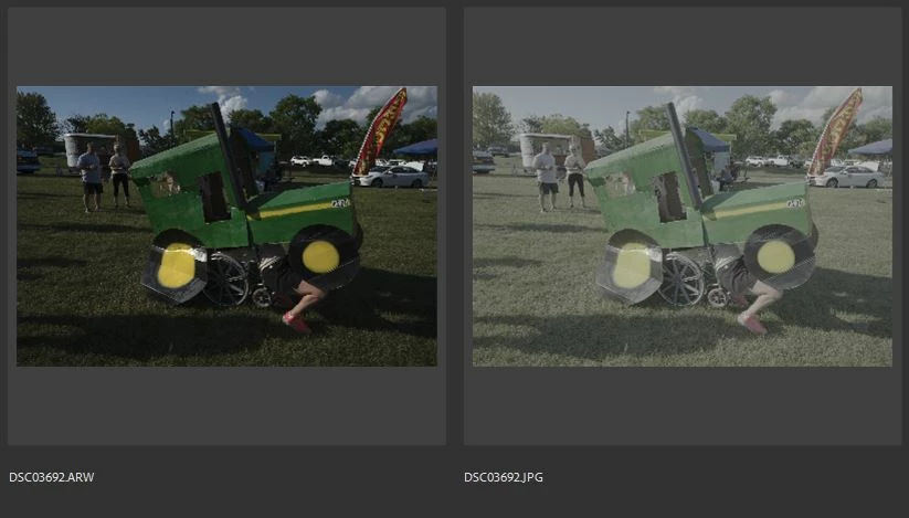

Hi there, I know the preview is just a generated preview and that the data is all there, but I am having a hard time working on these images because I can't even see the preview to see if eyes are closed or in focus (they are THAT dark).  For this particular event, I shot in bursts which means I have LOTS (1k+ photos) that I want to quickly shuffle through to grab the best ones.  I've used these cameras in the past (Sony A7Siii) with no issue so I'm stumped. I have Bridge 2022 and Bridge 2023 both installed with the same issue.
I read that there are options to change the preview but I can't for the life of me find those options.
Here's what I'm seeing (Raw on left and JPG on right):
I'm sure it's just an oversight on my part but I would appreciate any guidance.

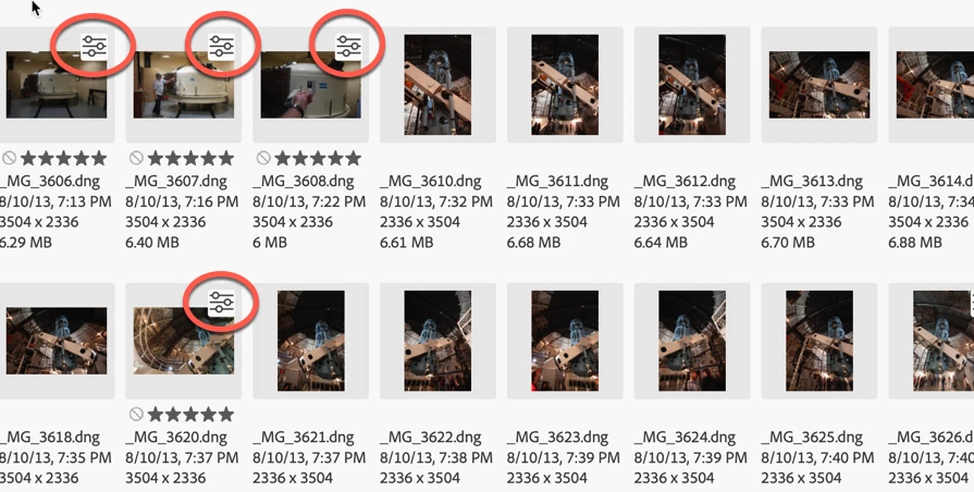

1) you've already set an "auto" on one image. If you look at all of your images in the Content Panel, you'll see that image has an icon in the upper right corner. You can see several of them here:
You'll note that images that you've not adjusted have no icon.

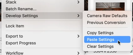

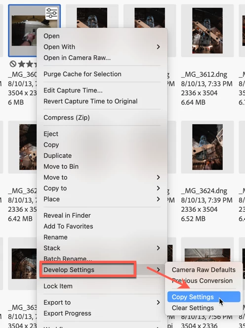

Now, right-click on the image you set the Auto on, drag down to Develop Settings, and select Copy Settings.
Now, select All of the image in that folder by pressing Command/Control-a.
Finally, while all of the images are selected, right-click on any of the images and return to the Develop Settings as above, but now select Paste Settings .

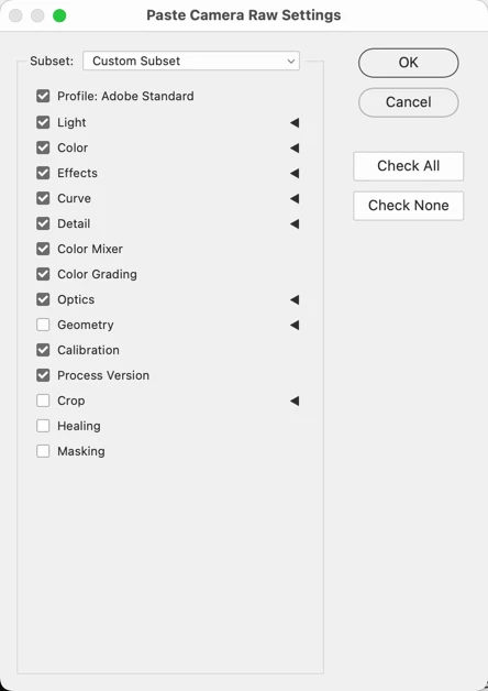

You will now see this window asking you what things you wanted to be pasted from the previous image you are copying from.
The options you see here will be fine. Do not worry about having an option that may not work on ALL of the images because all of the images should get some fine-tuning by your eye. Remember, Auto only gets you near where you want to be.
