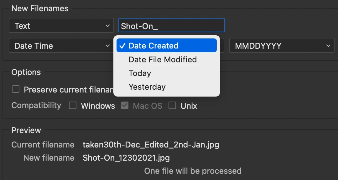

I believe that my reply was relevant. The date created is the date taken/shot.

It's working for me, so this does indeed sound like a preference reset issue as suggested by Sahil:

Could you try resetting the preferences of Bridge and let us know if it helps? https://helpx.adobe.com/bridge/kb/troubleshoot-errors-freezes-bridge.html
