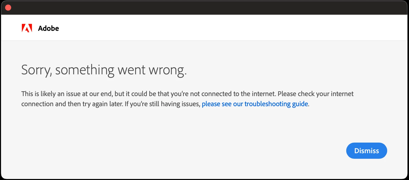

In the last few days i've been getting this nnotice when o try to use Adobe Bridge:
Sorry, something went wrong.
This is likely an issue at our end, but it could be that you’re not connected to the internet. Please check your internet connection and then try again later. If you’re still having issues, please see our troubleshooting guide.
The app just crashes and i can't use it.
Thanks.

Hi @Marisa Barbosa Fotografia   ,
Can you Share the Logs collected with Log Collector Tool with us at sharewithbr@adobe.com so that we can investigate the issue?
Meanwhile, could you please also try the below steps and see if the issue at your end is resolved?
1. Copy file  /Library/Application Support/Adobe/Adobe Bridge 2023/AMT/application.xml  to
                     /Library/Application Support/Adobe/Bridge/13.0/AMT/application.xml
2. Launch Bridge.
3. You may have to set the desired language after relaunch.
Note: Please create folders that do not exist while copying files in step 1.

Jan 25, 2023 10:12 PM UTC
Hi vijayn84325283,
Thank you so much for your answer.
Problem solved!
