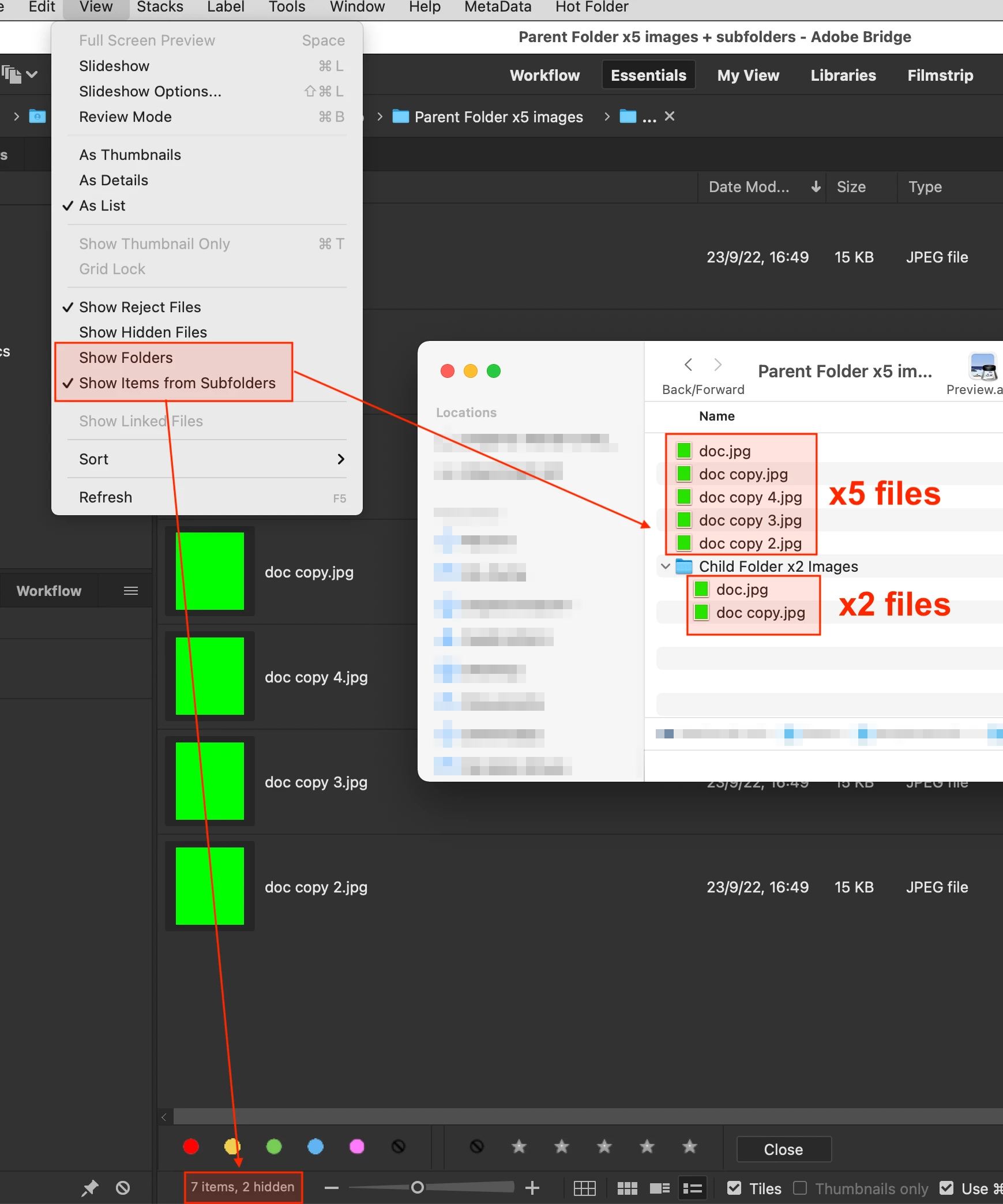

How to count files in a folder with other folders (holding images) in Bridge?
6 replies
Stephen Marsh
Oct 3, 2022 2:22 AM UTC
@Additus

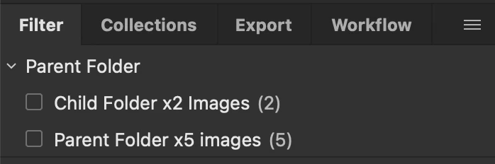

This is possible, however, you need to configure the View menu to Show Items from Subfolders and to Hide Folders as per the following screenshot:
Additionally, the Filter panel offers further information and viewing control (Window > Filter Panel).
AdditusAuthor
Oct 3, 2022 9:54 AM UTC
Excellent! Many thanks for your instruction!
