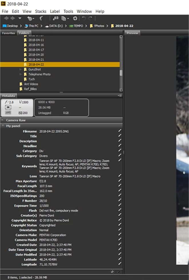

Hi everyone,
I am still following and still need to be able to edit the following list of metadata.
It is of interest to those using old manual lenses and those doing film photography.
title
description
Headline
Category
SupplementalCategories
Keywords
Lens
Max Aperture
Focal Length
Focal Length In 35mm Film
ISOSpeedRatings
F Number
Exposure Time
Flash
Creator(s)
Copyright Notice
Copyright Status
OrientationCamera Make
Camera Model
Created Date
Date Time Original
Date Modified
Latitude
Longitude
I really hope someone could help people using old style photography.

Yes I was entering this info into a custom XML panel in Bridge 2017 under Windows 10
Presently I am trying to create an extension for Bridge 2018, but I am not a programmer. I do my best modifying other people's scripts.

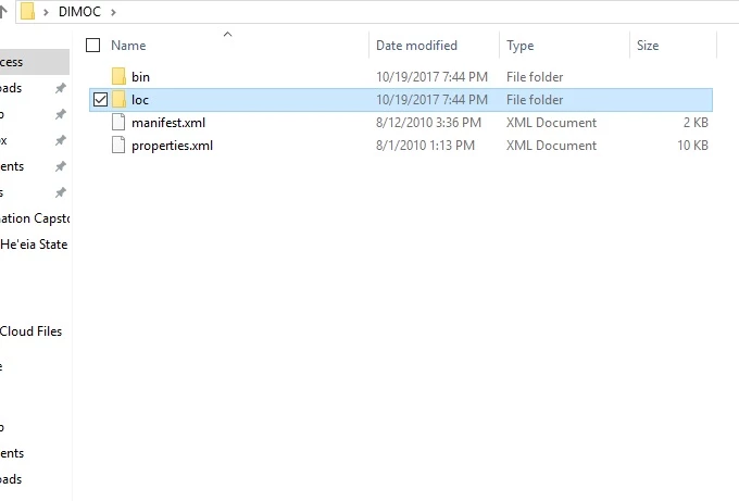

I am having the same issue where I was using a custom file info panel for years and now am unable to use it with the updated Bridge. I hope there is a solution since this specific panel is used my a good majority if visual information specialists in the Department of Defense. I tried to search for the location of the preinstalled DICOM folder to possibly locate the new folder location was did not find it anywhere.

I tried to run the converter tool but it states it cannot find a compatible panel to convert. All the default panels are in the XMP folder to include my custom panel. My panel worked just fine with CC 2017.
