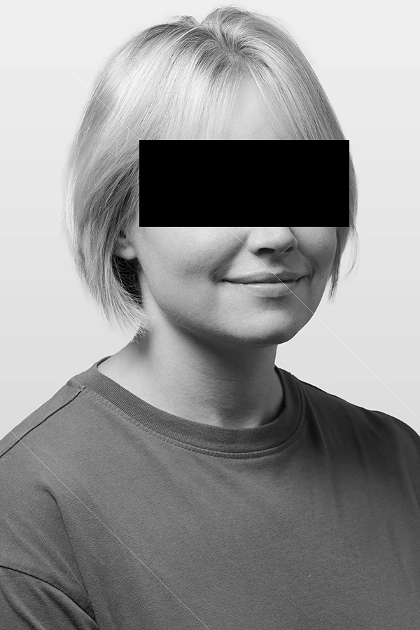

Diagonal lines in picture
Found a potential bug in Photoshop/Bridge, never encountered this before. I recently developed 6 portrait photos in Camera RAW. I then imported them into Photoshop (23.5.1) and did some retouching and saved them out as .PSD files. When I checked them in Bridge I discovered that four of them had two diagonal lines in the thumbs, always at the same positions, see attached picture.
At first I thought maybe it had something to do with my new Canon R6 camera, haven't used it much. But the RAW files have no trace of the lines, they only show up in the .PSD thumbnails inside of Bridge. If I view the .PSD files using XnViewMP there's no trace of the lines either. If I open the files in Phoshop, same thing; no lines.
I also get the lines if I use the Bridge Export function to save out the pictures. But if I use the Image Processor; no lines! Initially I suspected it might have to do with the flattened layer created by "Maximize Compatibility". But I assume that Bridge Export doesn't use that for export. Also, in that case the lines should have shown up in the thumbs in XNViewMp, which they don't. So has anyone encountered this before? So far it has only happened to the four pictures that I developed this week...

So no one has any clues about this or been subjected to this bug?

I've never seen that issue here no, although I do tend to use Lightroom more than Bridge.
A couple of questions that might enable others to help you:
Is Bridge up to date? (Check Help>About Bridge)
Do you use 100% previews (check Tools > Cache >Manage Cache)
Dave

Sorry, forgot to include the Bridge version, it's the latest one; 12.0.3.270. And yes, I use 100% previews, but I have tried to purge the 100% cache, no difference, the lines are still there. Are the 100% used by the Export function in Bridge? I believed it didn't used cache information and relied on the actual information in the file...
