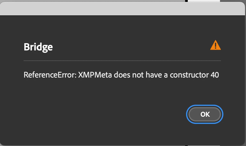

Hi David,
Just tried to run the script through Bridge and I received an error message as per the attached screenshot. Have I done something wrong? Thank you.
Best regards Paul
