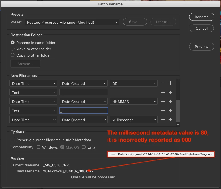

It should be possible in Bridge's Batch Rename tool, however, the millisecond value is incorrect – making it useless:
Which is why I believe that a Bridge script or ExifTool would be required.
