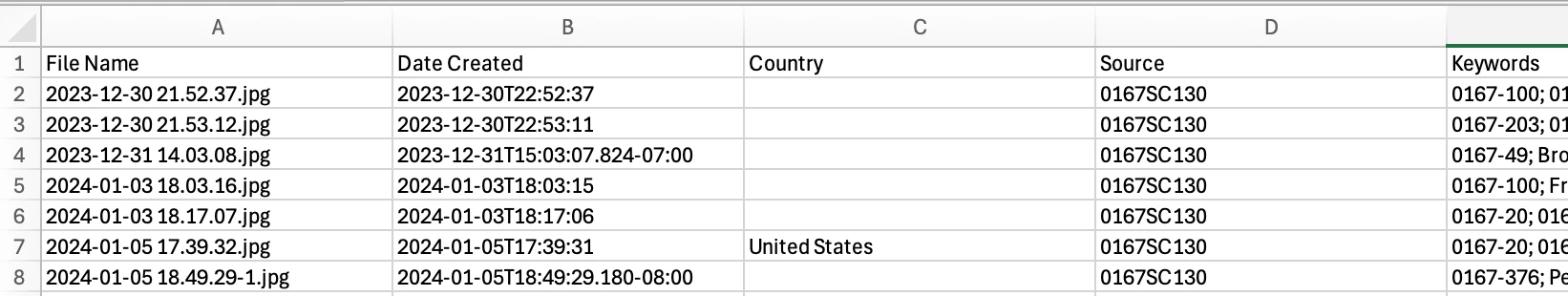

The Utility Script Pack listed above, I have found to be quite helpful, thanks for providing this. I am very close to the export I need, but it appears I am attenpting to find an uncommon field of metadata. Will this script export just as shown in my screen shot, but instead of "File Name" for the first column I need xmpMM:OriginalDocumentID?
I suspect the same field is also sometimes called Exif.Image.RawDataUniqueID (trying to confirm they are the same).
I also suspect this metadata field is the same exif:ImageUniqueID (trying to confirm still).
