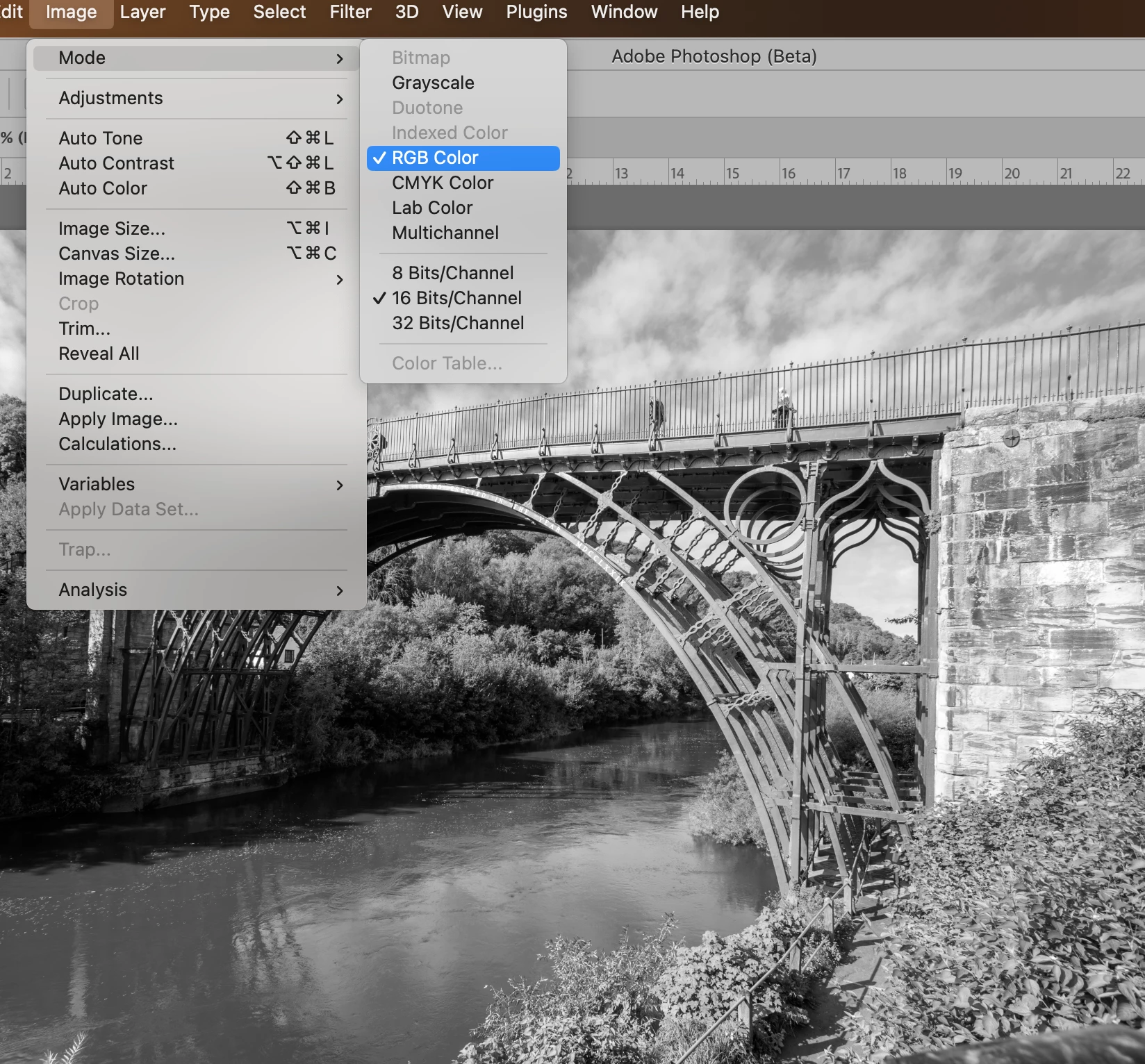

(I wish you had added that detail earlier)
OK, was the image created in PS saved as a Grayscale image or was it saved in RGB but looked as a Grayscale image? Can you share the original image in question? And/or can you provide a screenshot of the image. If you look at this image, it's black and white, but the image is still in RGB.
