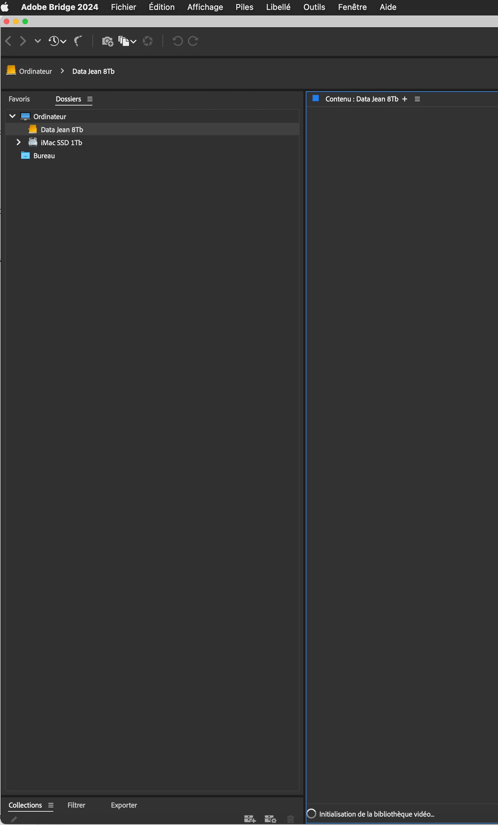

External disk data display problem in Bridge 14
After updating Bridge (14.1.2), the application recognises my external drive where all my personal folders are stored, but it doesn't display the tree structure, so I can't view any photos.
I'm using an Imac with macOS Ventura 13.6.9
I had the same problem with version 14.1.1.
So I reinstalled version 14.1.0, which works normally.
How can I solve the problem of updating to the latest versions of Bridge? Please note that all Apple accessibility settings have been checked and are correctly activated.

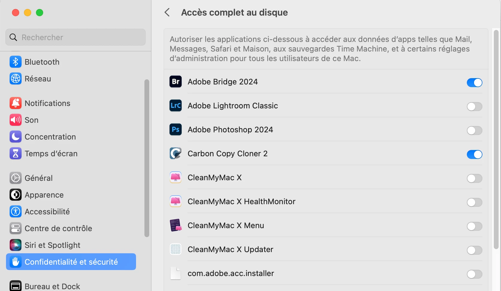

This sounds like you've not given Bridge permission for Apple's protection. Simply, this is an Apple protection issue, not Adobe's issue, and when you updated Bridge, you need to redo the permission issues.
Go into the System Preferences and select the Privacy & Security tab on the left. Note that there are two options on the right you'll need to deal with: "Files and Folders," and "Full Disk Access."
First, going into Files and Folders, note that in various years of different releases of Adobe Bridge, different needs are needed. I do not know why this is, but it's always better to check and make sure that just because you did it for one release, you may or may not need it for a subsequent release.
Lastly, go into the Full Disk Access option. If you do not see your application in the list, click on the "+" symbol at the very bottom of the window. This will bring up a standard Finder window. Navigate to your Applications Folder, find Adobe Bridge, and add it to the list (You will need to add your Administrator's password to do this.). Then you can "switch" it to the "ON" position.
This should solve your problem.

Aug 17, 2024 3:46 PM UTC
Many thanks for your detailed and explicit reply.
In fact, Bridge did not appear in the “full disk access” function, but Photoshop and Lightroom did (but were not activated). So I added Bridge but activated the full disk access function. When I opened the application, the tree structure appeared correctly. The problem is now solved.
Once again, thank you and good luck!
