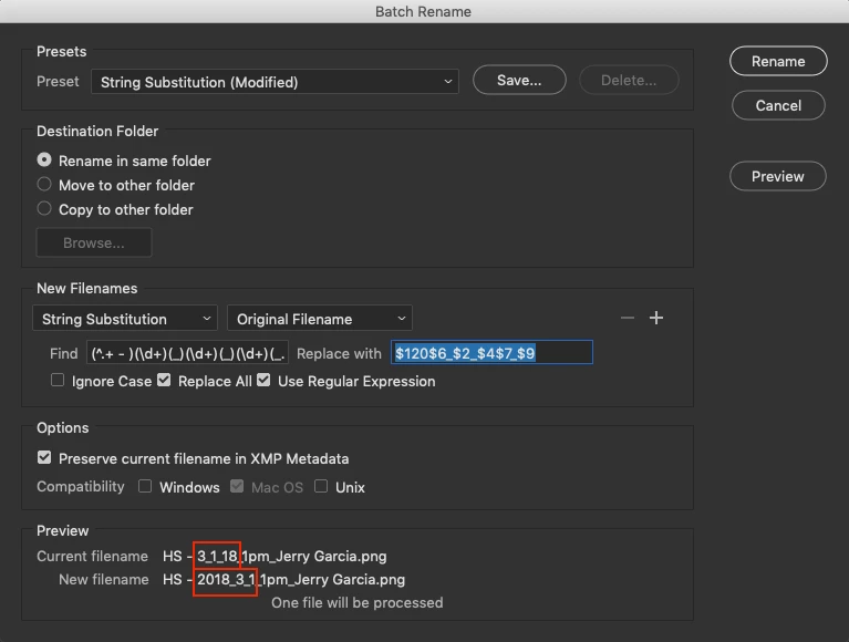

I am trying to understand the RegEx syntax to accomplish a limited scope of rename/reorder operations for migration to a new MAM/storage system. I have thousands of files with file names resembling the following:
HS - 3_1_18_1pm_Jerry Garcia
and need to identify and reorder the date/time string from the existing M_DD_YY_Ttt format seen above to the new format of:
YYYY_MM_DD
and then possibly rearrange the different elements of the filename.
I have used Bridge extensively in the past for basic find/replace and sequencing jobs, but I have been unable to find a good primer on the RegEx syntax for advanced string substitution. Please advise.
Stephen Marsh
Stephen MarshCorrect answer
Sep 22, 2020 10:59 PM UTC
Presuming that the year should be changed from 18 to 2018, one method would be to use Bridge's Batch Rename as follows:
Find:
(^.+ - )(\d+)(_)(\d+)(_)(\d+)(_.+)(_)(.+)
Replace:
$120$6_$2_$4$7_$9
Of course, it will not be that easy, as you probably also wish to pad out single D and M values to be DD and MM as well as the presumed 20 padding before the year to make YY into YYYY.
Find:
Replace:
$120$6_$2_$4$7_$9
