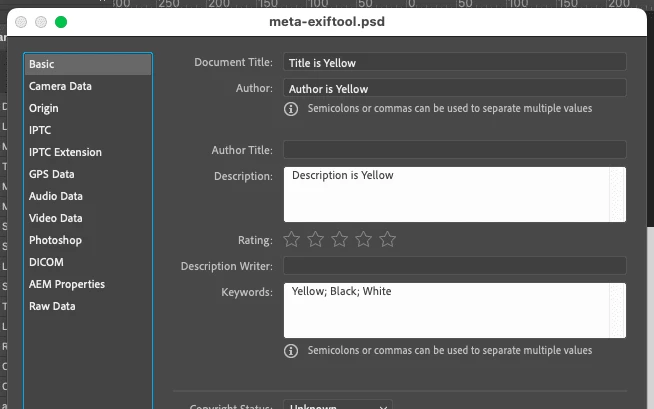

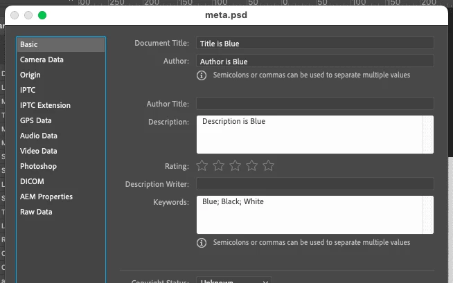

Here it is for ExifTool:
exiftool -api 'Filter=s/Blue/Yellow/g' -TagsFromFile @ -IPTC:Caption-Abstract -IPTC:By-line -IPTC:ObjectName -IPTC:Keywords -XMP-dc:Creator -XMP-dc:Title -XMP-dc:Description -XMP-dc:Subject -IFD0:ImageDescription -IFD0:Artist 'Path to File or Dir'
Changing case-sensitive Blue to Yellow - formatted for the Mac with single-straight quotes (Windows would use double-straight quotes).
Before:
After:

You're welcome, however, as I mentioned earlier, you need to be specific about which metadata fields!
As you can see in Adobe File Info, there are only 4 entries for Blue, however, I needed to perform the find/replace in 10 different entries to completely cover the 4 instances. Many entries are written to multiple fields, if you miss some then you may get different/inconsistent results in different software.
