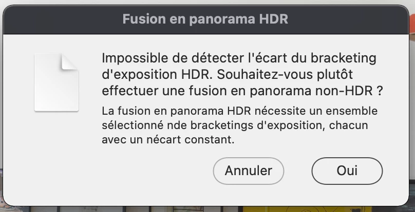

J'ai toujours ce message quand je tente d'assembler un pano HDR avec Adobe Camera Raw. (Version 13.2)
Pas de souci pour assembler un HDR avec des vues fixes. Pas de souci si je passe sur LR (mais cela ralenti beaucoup mon flux de travail).
Des idées sur ce problème?

gary_sc
Mar 17, 2021 5:21 PM UTC
Good day Olivier,
I do not have any issues or problems when I'm doing an HDR Pano so I know it's possible. According to Google-translate, I was able to look at the text of your error message as:
"Cannot detect bracketing deviation
HDR exposure. Would you rather
to merge into non-HDR panorama?
Merging into a HOR panorama requires a set
selects nde exhibition brackets, each
with a constant necart."
Can you please let me know the how many stops inbetween each image? That is, generally one might have the bracketed exposure settings to provide -2, 0, +2 stops for each shot of the panorama. What are your settings? Also, can you please provide the exact process you are doing for your HDR-Pano?

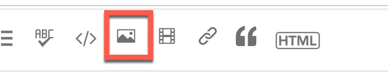

Lastly, when sharing screenshots, PLEASE use the icon above where you enter text to place the image into the message. I'm talking about this icon:

olivierMGAuthor
Mar 17, 2021 6:51 PM UTC
Hello Gary
Yes I do provide at least -2, 0 +2 for each pictures.
My process: pictures are displayed with Bridge, then opened with ACR plugin, from ACR I select my photos and rght click gives me acces to HDR (which works) or Pano HDR (that as never worked....)
