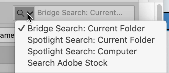

Jan 23, 2021 9:42 PM UTC
Hi Fred,
Try playing with the dropdown menu in the upper right corner of the Bridge window and see if that solves your problem. The issue is that Bridge needs to be IN a given folder to search in that folder. If you open an image from one folder, you can see the keywords used in that folder, not the rest of the folders that have images contained therein. It is a limitation of Bridge but not Spotlight.
