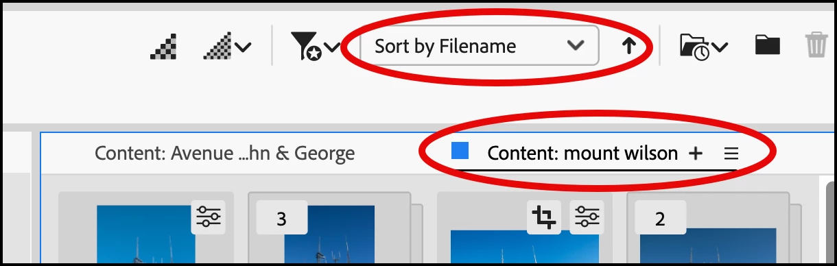

Hi, @compupix, good question, and there is an answer: In the Content Panel, you can have multiple Content Tabs. Here is a screenshot where I've focused on one folder and set that to Date Created.
 Then I went to a second folder in a second Content Tab and had that one set on a different folder and set that to Filename.
Going back and forth was easy and did not lose its focus.
I hope this helps,
