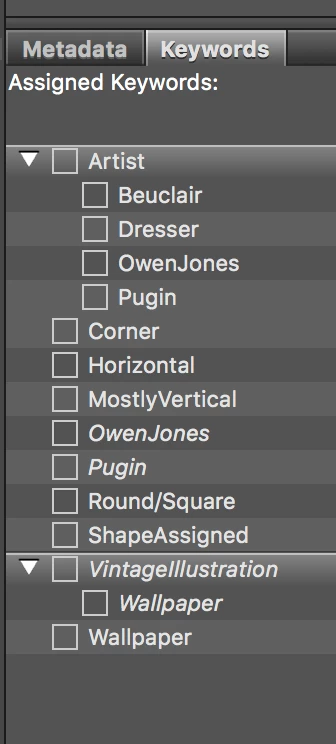

    It also sounds like you may possibly have a mixture of standard and hierarchical keywords applied. Are any metadata panel entries listed under “Other Keywords” in italic?

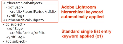

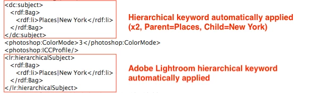

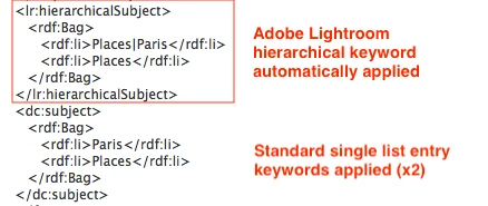

    Can you please show some screenshots, from both the keywords panel and by selecting a file and using File > File Info > Raw Data and the text metadata presented? Similar to these random examples:

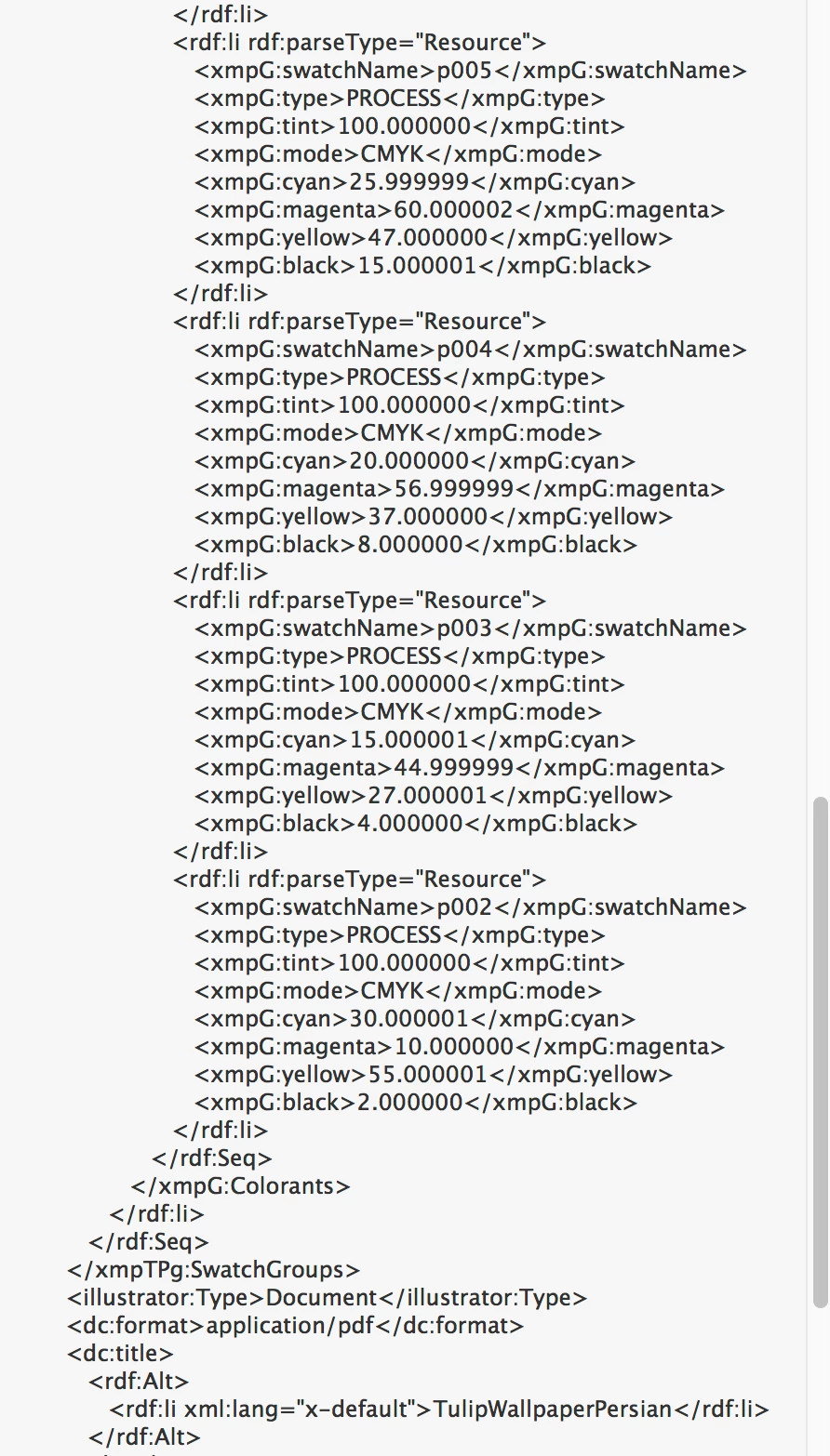

    Yes, some of them are in italics.

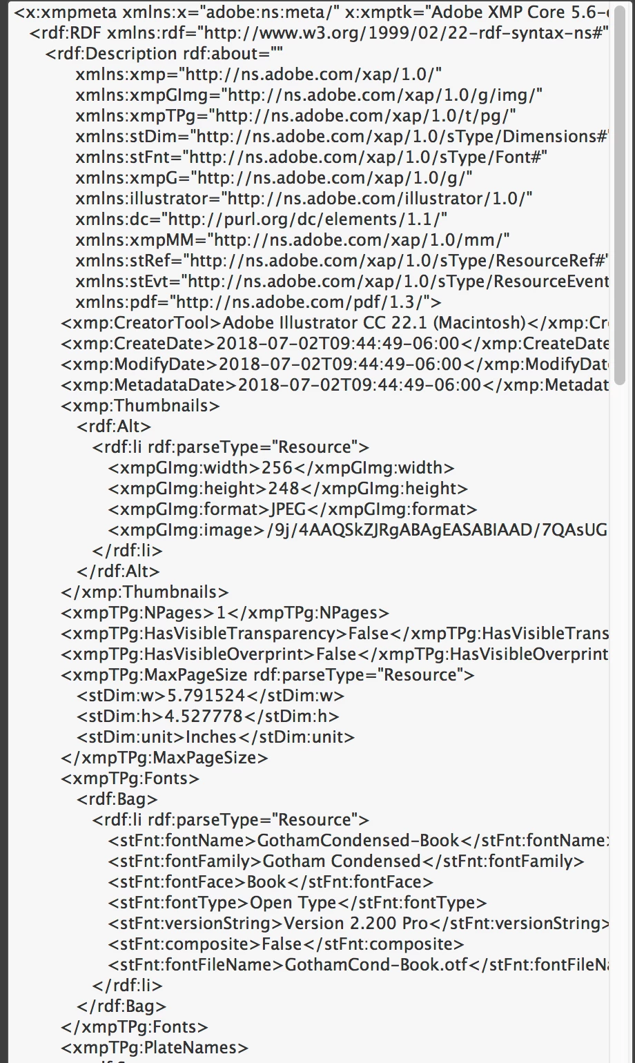

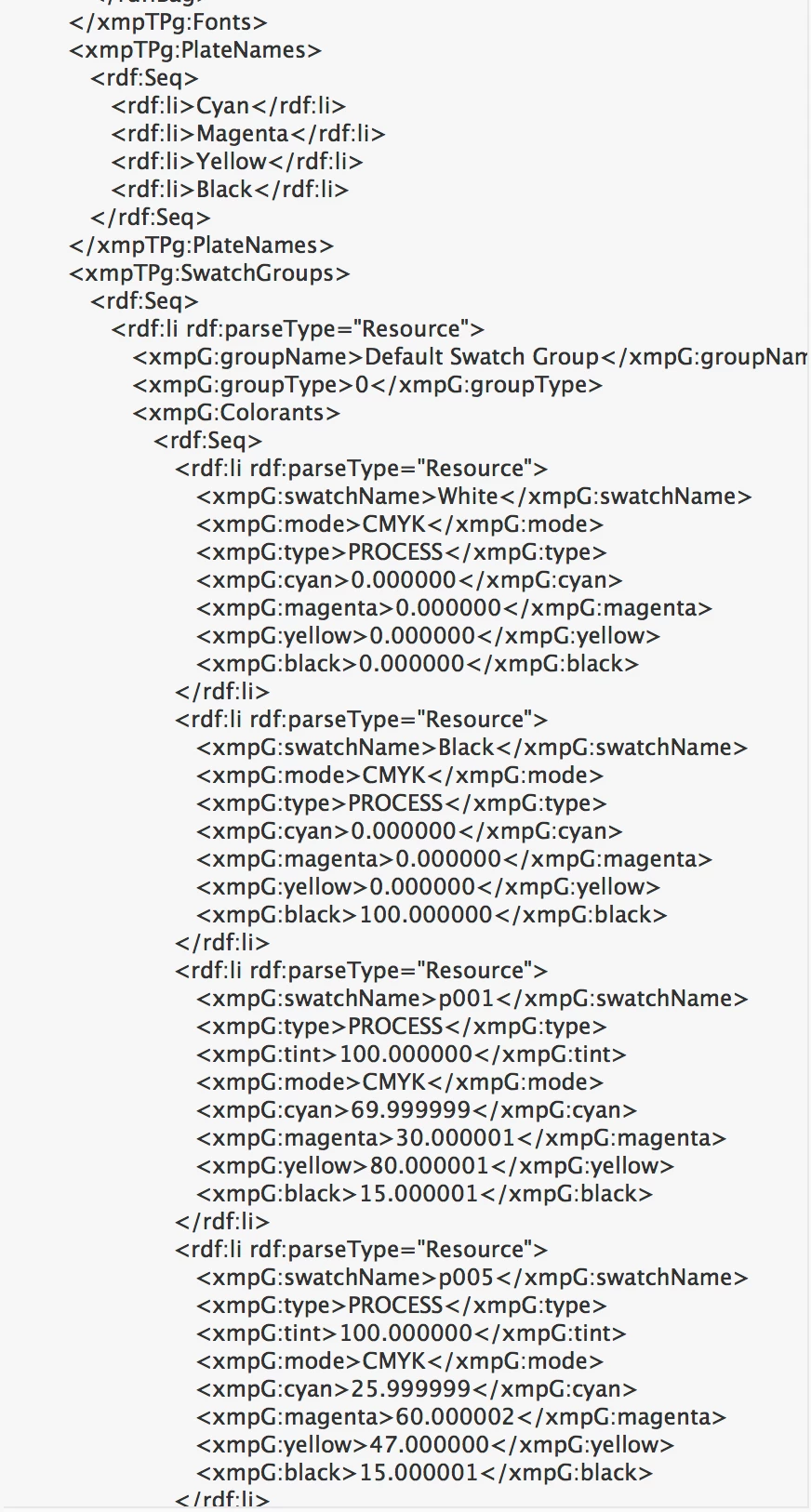

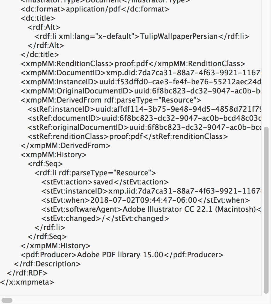

    I'm afraid I couldn' figure out how to do the other thing you asked for - I got a VERY long list of stuff, and couldn't spot any of it that seemed to be relevant. Here it all is.

    Italics means that the keywords are “non persistent” – they exist in the browsed file, however there is not an exact match in the list of keywords in Bridge.
    The File Info Raw Data option has a search field, search for subject to try to track down the keywords as in my screenshots. Your sample file appears to be an Illustrator file, it may or may not have any embedded keywords in it.
    You can use the Filter panel to isolate groups of keywords, which may help you to consolidate them, or at least work out how many conflicting groups there are.

    Either Bridge and or ExifTool would be useful in cleaning up the mess, however you first have to look for existing patterns/structure and then work out how you wish to clean up the files using this existing structure as a “hook”… Otherwise simply batch remove all keywords and start fresh.
