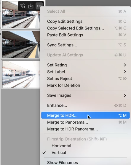

Since you're taking raw images (GREAT!), this is easy: select the three* (or more) proto-HDR images in Bridge, right-click, and select "Open in ACR." After ACR opens, select the same three images, and right-click on them again, you'll see this option:
Notice also that you get the other options of "Merge to Panorama" and "Merge to HDR Panorama."

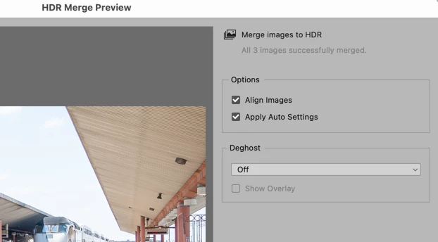

When the new window pops up, make sure that you have the "Align Images" checked. Also, see if "Apply Auto Settings" is checked. I prefer using the Auto as it gives me a leg up on operations.

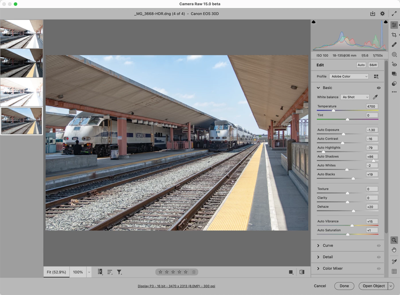

After you OK this, you need to save the new DNG file into the folder where the proto-images are held. Then, finally, you can fine-tune the image in ACR.
