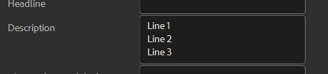

You want to do something like this in Bridge?
If you use the IPTC Core metadata panel and add a line break (Enter) for each new line, that should work.

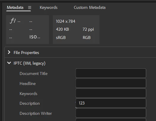

Keep in mind that some other apps don't display line returns, so if you share the photo with someone who views the metadata in Finder, or some other photo app, they might see the separate lines bunched together (that may not be an issue, just saying it can happen). Oh, it actually happens in Bridge 2023! IPTC (IIM legacy) will display it like this:
This is a bug that I will report to Adobe.
So, don't use the IPTC IIM panel, use IPTC Core.
