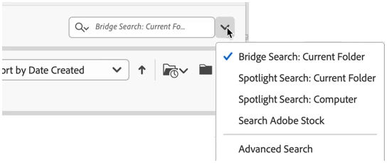

Sadly, any work using any Cloud service with Bridge is going to be iffy. This is because Bridge was designed to work with local hard drives and the host computer. The fact that it's working with one computer is good.
Meanwhile, the only other thing I can think of for you to check is to make sure that you're searching in the right area. Please check if you are searching with the correct tool and region here:
Let us know if this helps,
