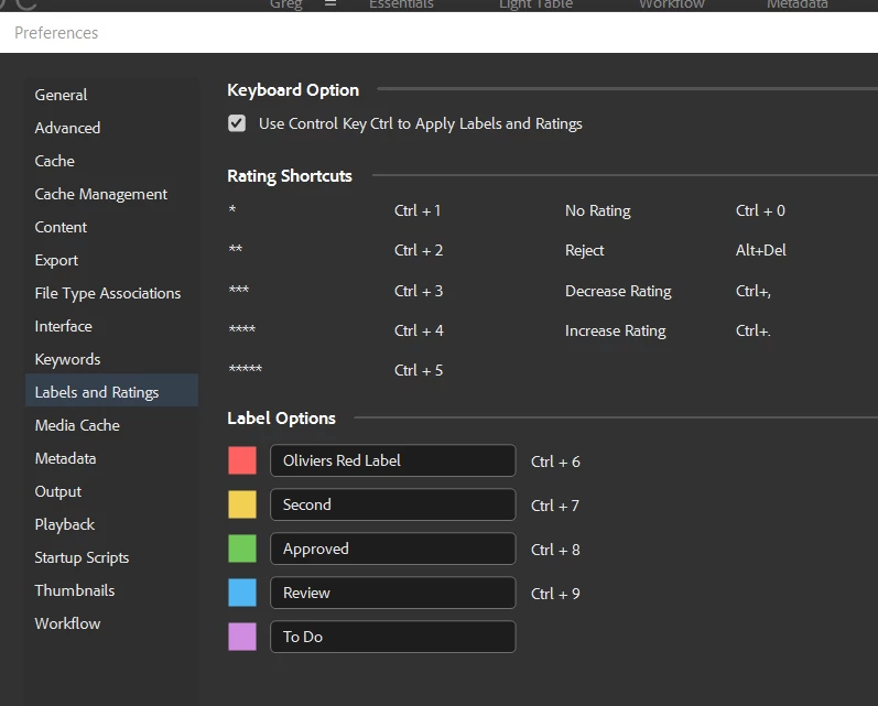

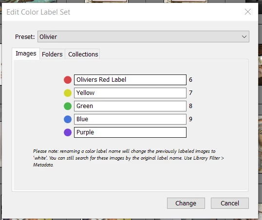

When I change my label color in Bridge, the same color doesn't shox off in Lr.
Similarly, if I change it in Lr, it doesn't appear the same way in Bridge. Instead of the correct color, a white generic label appears.
Does anyone know how to have a painless synchronization of the labels between these two apps ?

I assume you are importing and exporting file between Bridge and Lightroom and using metadata synch rather than changing the label in one app and expecting to see it change instantly in the other app.
If I'm right, then the white label you are seeing in Bridge is most likely caused by a change in the label text. If you customize the label text in one app, you have to also change it in the other app, otherwise the label will be read as an unknown, generic white label.
Be sure that the label settings are the same in Bridge and Lightroom.
