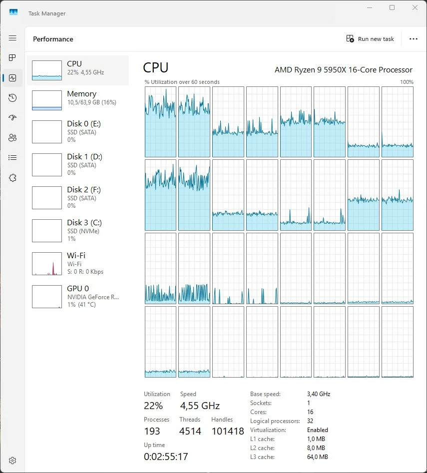

When using the latest version of Bridge (15.0.2.432) I have noticed that sometimes Bridge has a continued (very) high CPU usage for no reason. I can reproduce this 100% (system details below):
  1. start Bridge
  2. enter "maximized" mode for the Bridge app window (so that the Bridge window fills the whole screen)
  3. enter "Filmstrip" mode
  4. go to a folder with more than around 40 images (see below *)
       (I have tested this with both small JPEGs and with large TIFFs, see also about filters below)
  5. Bridge may or may not generate thumbnails and/or previews (does not matter for this bug/problem)
  6. wait until the CPU usage for Bridge falls to its idle level (around 0.1% in my case)
  7. now enter "Light Table" mode
  8. at first nothing happens
  9. cover part or the whole Bridge windows with another app (I used the Task Manager when experimenting)
  10. then bring the Bridge window to the front, so that the Bridge window is fully exposed again (letting the Bridge window get focus)

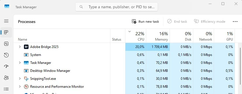

  11. almost immediately I observe a very high CPU usage level (see attached screen dumps of Task Manager)
  12. while this is going on I can see no disk activity at all generated by Bridge. Bridge seems to consume CPU resources for no apparent reason. This goes on (forever) until another screen mode (like back to "Filmstrip) is selected or Bridge exit.
*) during my experiments I noticed that when the number of images shown in "Light Table" mode is equal to or less than 36, everything works normal (no high CPU usage). When the number of images shown in "Light Table" mode is greater or equal to 38 however, the high CPU usage occurs.
Note that normal (low) CPU usage is observed BOTH when the total number of images in the folder is less than 36 OR if filters are applied before entering "Light Table" mode that results in less than 36 images shown on the screen when going to "Light Table" mode (no high CPU usage even with a folder with a large number of images if filters limit the number of images shown).
This makes Bridge almost unusable in "Light Table" mode (sluggish, PC fans accelerating).
