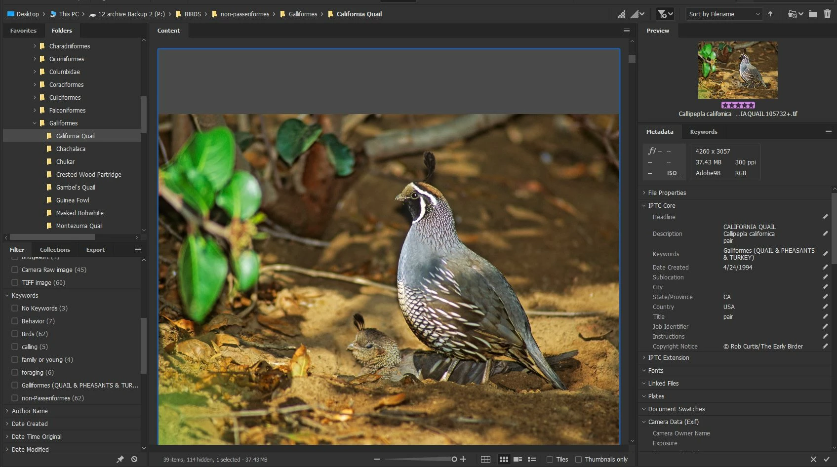

metadata changes problem
I started using Topaz denoise and a strange problem arises.  In the description field, I have a scientific name followed with 2 spaces by common name.  ie. Canis domesticus  DOMESTIC DOG.   At some point in the past I had the reverse,  DOMESTIC DOG  Canis domesticus.  The order is important, because I use captions which take this in galleries and sort species alphabetically.
So when I go through a folder of tiff in Topaz, making individual changes, I find that many, sometimes almost half change from the present order to a previous order, and also I noticed one had the keywords change.  In a family folder, there may be slide scans, or digital shots but the type or date doesn't seem to matter.  I saw some from 1997 or 2002 that didn't change. In another case, I saw that the location was missing in the metadata and added that and sublocation.  When the operations were completed, I saw that the location and sublocation data were there but the naming order reversed to the earlier time.  Does it have something to do with the way xmp data was originally stored or media cache?  I think at some point in my history of using Bridge, I selected the option to have cache data in the same folder.
Topaz says they have no idea why it should change, but it is requiring a lot of correctional steps and time for me, and sometimes I don't notice till it's out of order in a gallery, and even more work.

I much appreciate the involved efforts to help with the coding and all.  I finally figured out why some do revert and others don't, regardless of date, digital or slide scan.  If the metadata, such as description, or keywords are changed in the right panel, that data will always show as current when Bridge is opened.  But if the file is not resaved after such changes, Topaz will go to what it was when previously saved.  So I created a simple action, resave, which opens the chosen ones in a folder and then choose 'save as' with the same name, so nothing changes, then none will revert.  If I just open and save it doesn't change, it has to be 'save as' to be new and saved with the updated metadata.

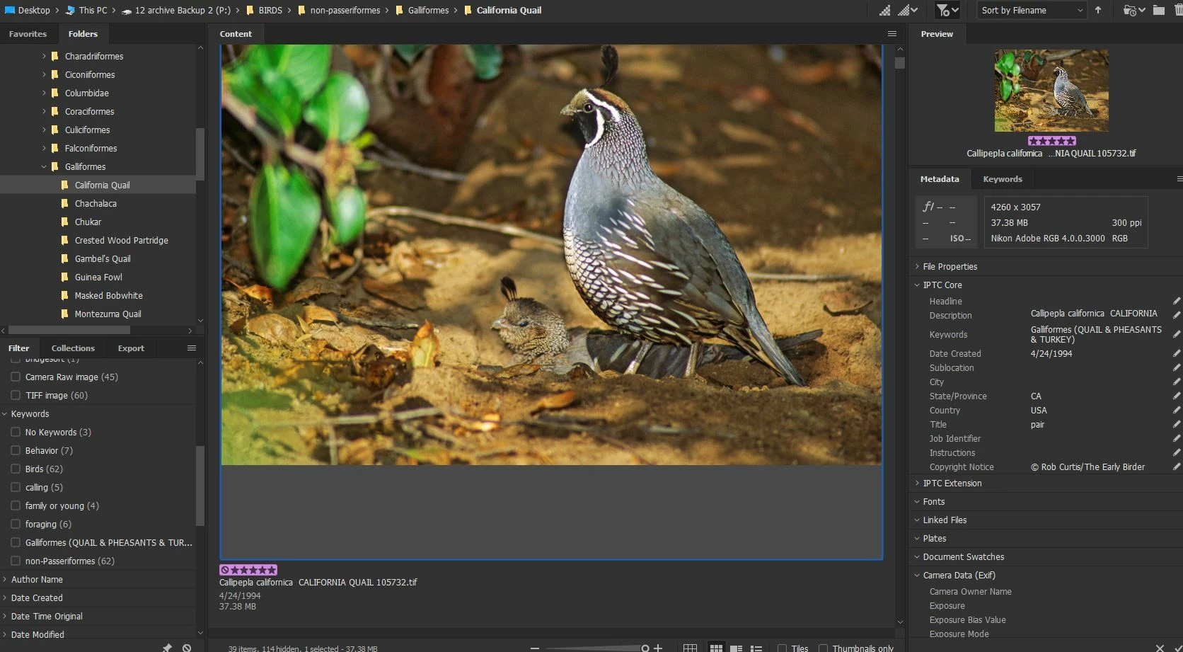

I am using tiff files.  When I tried a raw, it converted to dng, and all the data was stripped.  Then I saw I could save as tiff instead, but again all metadata was stripped.  So odd that I can't predict which tiffs will have their descriptions reverted to an earlier form. Maybe if the description was added before or after making a tiff from a RAW file.  So if it was added before it would be saved, while if added to a tiff it wouldn't?  But then it accepted location data added to a tiff and kept, while changing the description.  Weird.
With a Bridge script, could I just select a batch that had name changes (though they are different names) and reverse.  The 2 are separated by double spaces so that when I import chosen metadata into a database, I use 'replace all' double spaces with a tab to get 2 fields for the database.
I just looked further down and saw a solution for Lightroom was to save metadata to files.  But in Bridge I only have a metadata menu with a custom 'extract metadata' which I use to import to a database.  Could a script 'save metadata to files' be put here.
Mar 4, 2021 1:35 PM UTC
In this folder, I went through and changed any that had the old style to the new.  Then I closed Bridge and reopened, thinking maybe since export metadata to folders is checked maybe it would save.  Maybe it's the opposite. The Topaz processed one (with +) reversed and with pair added,
as well is what came out of the original.
