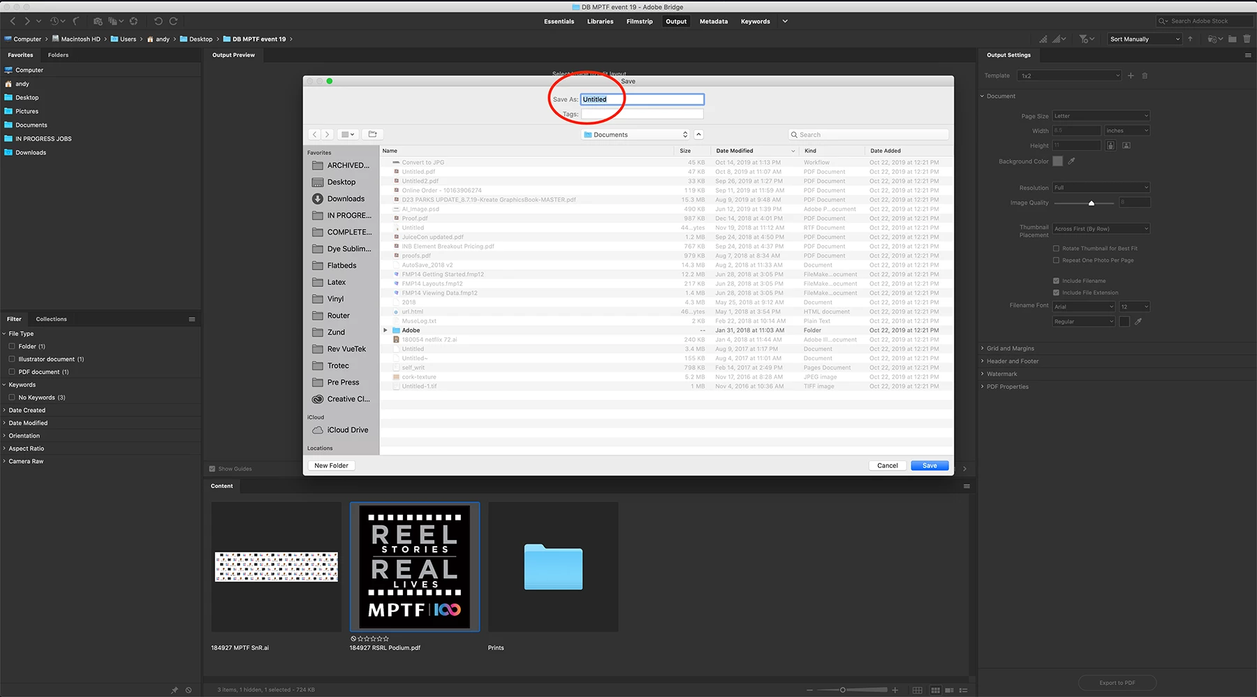

OUTPUT: Bridge won't auto open PDF
I have notice my bridge stop auto opening my PDF. The settings are checked but notice that when I rename the PDF, bridge doesnt include file extension after untitled. I tried everything to reset presets.

    What version of macOS and bridge are you using?
    Looks like your using macOS Catalina 10.15. If so, you most likely need to add the .pdf extension yourself until adobe fixes the issue.
    Or try the Bridge 10 prerelease from here:
    https://www.adobeprerelease.com/

    Oct 28, 2019 1:48 AM UTC
    It will be fixed in a future update.
    They need to be approved for the prerelease site
