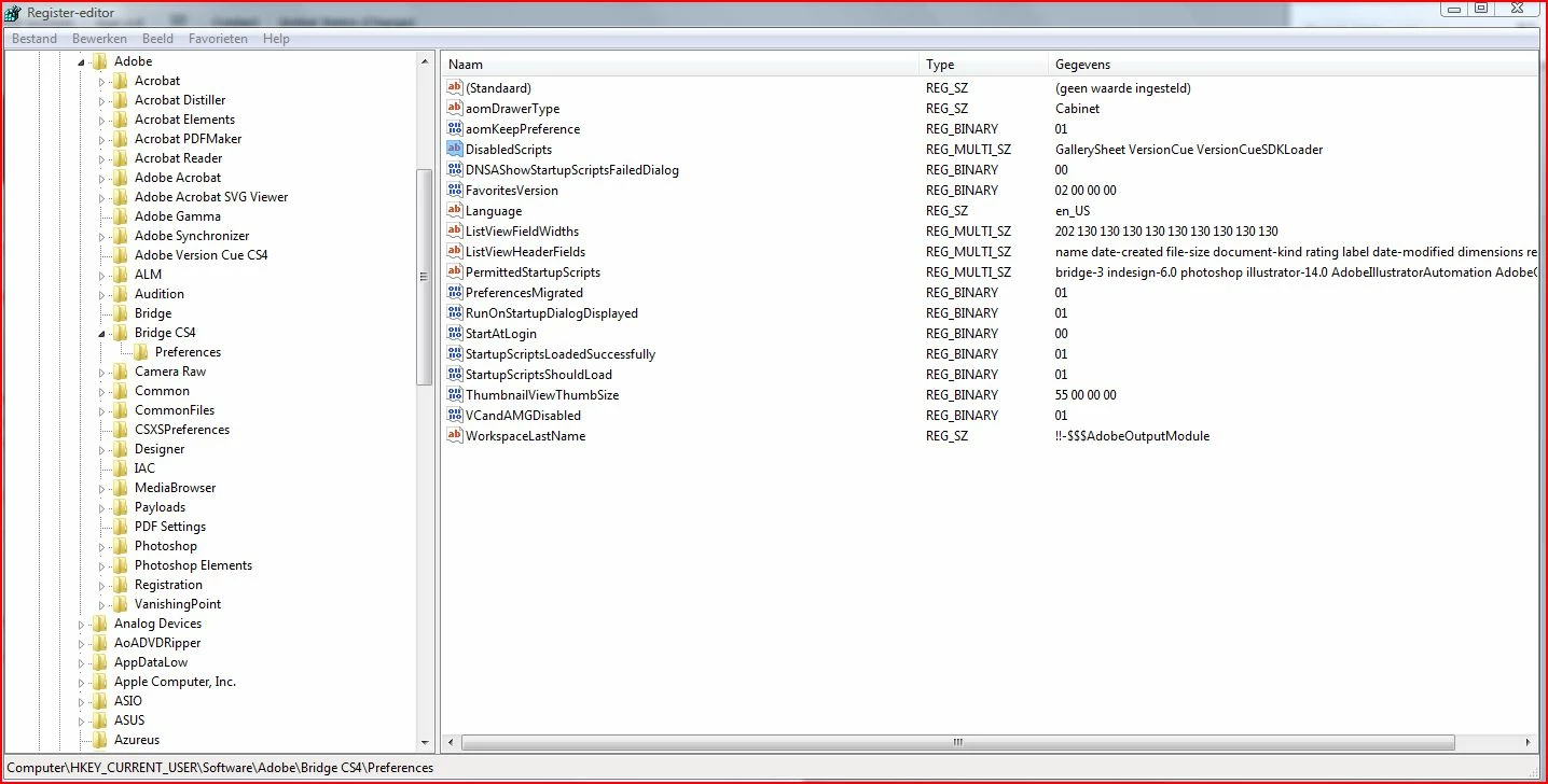

Attached you'll find a sreenshot of the registry key after deleting the key and starting Bridge again. One of the values says that the a script (gallery sheet versionCue ...)  is disabled. Any idea if that has something to do with the problem? Do you also havew this registry value?
Sincerely
Aart
