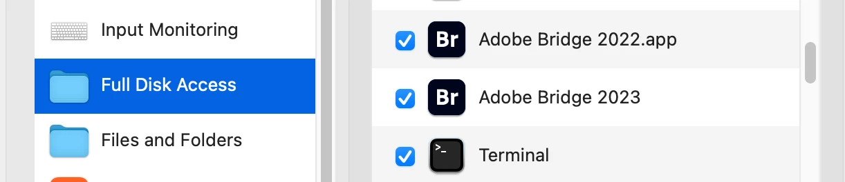

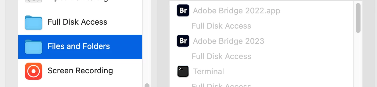

gary_sc
Nov 21, 2022 4:53 PM UTC
Hi, @Wes Duenkel
Just out of curiosity, have you set your system prefs to access any folder or device? If you have, have you done it since the latest Adobe or Mac OS update?
Here are the instructions if you need them.
[Note: if you are using Ventura, the look of this has changed. But what I show below is sufficient for you to figure out what you need to do.] Go to your System Preferences and select Security and Privacy (found in the top section). Now click on the Privacy setting (last tab). Now click on the lock on the bottom left and provide your Administrator code. Now select the Full Disk Access option and click on the "+" symbol. This will bring up the standard Mac Open window and let you add any application you want or need to have full access. Look for Bridge, and select it; it will now appear in that window, and make sure it's checked. Next, go to the Files and Folders option and do the same thing as above (although there's nothing to check, just add. Close everything down and see if that makes it all work.
Please let me know
[Note: these images are from an older OS, the process is the same.]
Wes Duenkel
Nov 21, 2022 5:04 PM UTC
gary_scYes, I've done this and it's still "broken."
