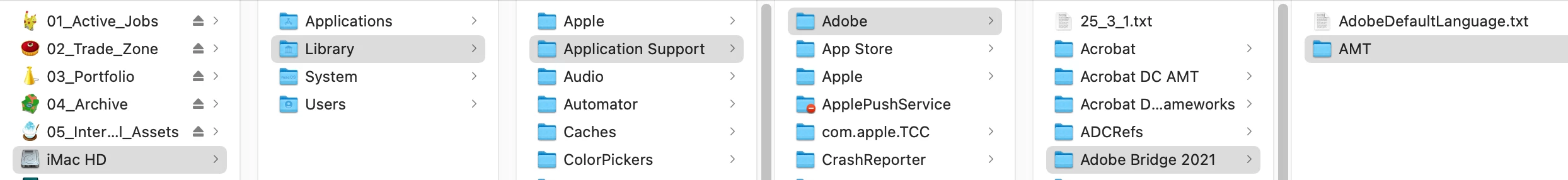

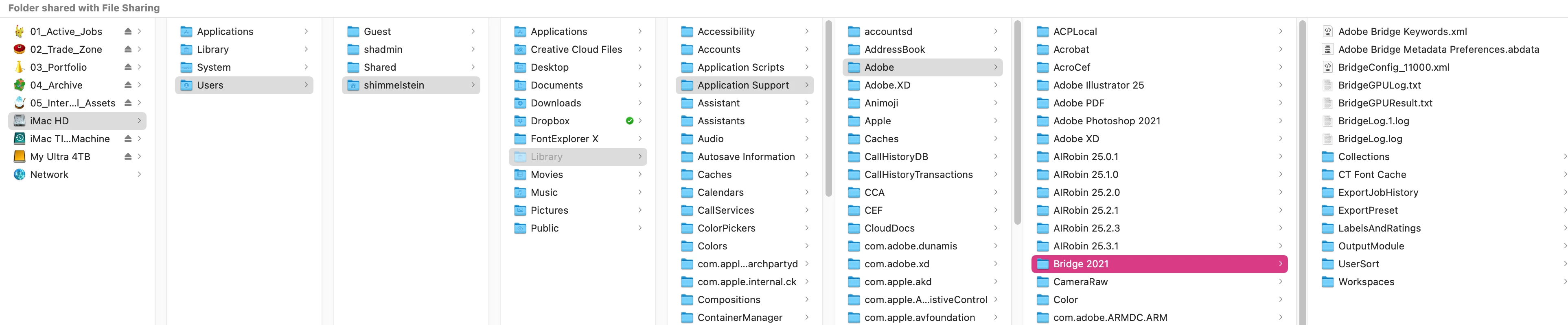

i did this, substituting 2021 since that is the version on my computer, and it created a folder in the Library but not the hidden library of my user folder name. there there is one for bridge.  (see the screenshots attached).
and as gary noted below the CC seems dropped from the later version name as seen in the screenshot of my user folders library.
in the meantime, i'm trying uninstalling and reinstalling bridge, and see what that does.
