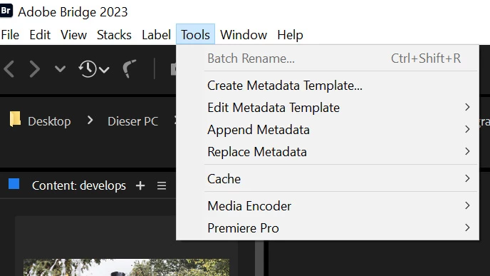

Photoshop vanished from Tools in Bridge 2023?
Many people have written on why Bridge 2023 is a mess, but I couldn't find anything on this particular issue: I want to open multiple pictures as layers in Photoshop. This option could be found under tools > Photoshop > open as layers. As you can see below, this option doesn't exist in Bridge 2023. Beind fed up with it, I reinstalled 2022, but apparently it doesn't recognize PS 2023 and asks me to install the newest version of PS.
Honestly, I can't tell you how many days this update has cost me so far. Each picture takes more than a second to load in Bridge now, just to skip from one picture to the next. I have to cull about 5000 pictures per wedding and it has become an ordeal now.

Hello @julias1741454
And here's my screenshot inside Bridge 2023
What I believe happened is that you installed Bridge AFTER you installed Photoshop. The scripts you see in the Tools menu are installed not by Bridge but by Photoshop. However, if you installed Bridge AFTER PS, when PS was installed there was no Bridge 2023 installed so it couldn't insert the scripts into Bridge.
To fix this, uninstall PS and then reinstall PS. That "should" fix it. SOMETIMES, you have to reboot your computer before reinstalling PS but this has not been consistent. So, I do not want to say this is something you need/must do.
Please let us know if this solves your issue.

Nov 1, 2022 11:50 PM UTC
