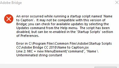

Hi, Thanks for the script but i'm getting an error.

Dec 28, 2017 12:09 PM UTC
Later I changed code I posted originally but I see you used that previous. You can remove white spaces characters which are after slash '\' and then save code again or just use newer one with corrected part. But the best will be if you copy a code you have in my previous post. Remember there are 2 bugs later I'll fix. It's not hard, but I'm at work right now.
NtC = new MenuElement("command", "Name to Caption", "at the end of Thumbnail")
