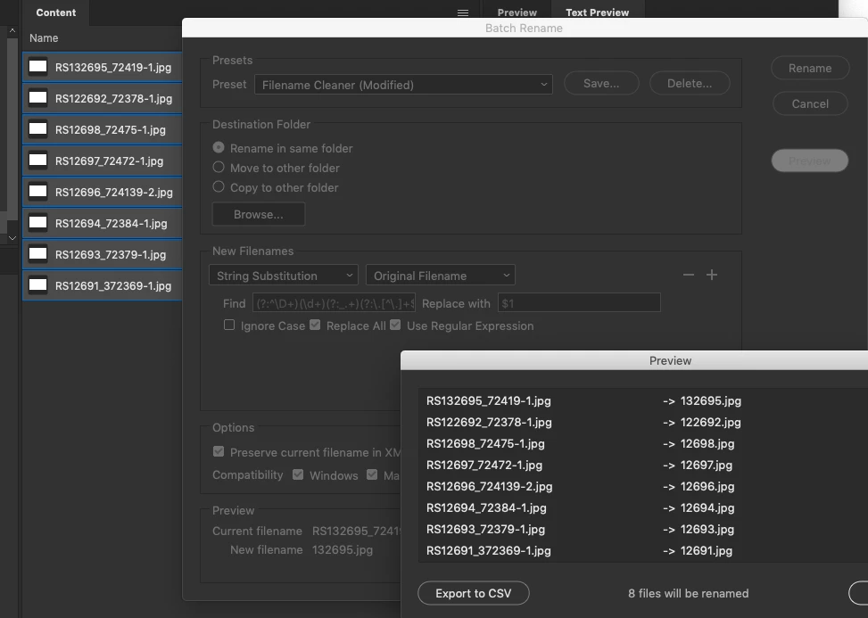

As I mentioned above I have different files, need to change as below(need to remove RS and from _/d{5-6}-/d) )
12691
12693
12694
12696
12697
12698
122692
132695
the extension should not be added, I need the file as Unix format. Could anyone help me with this?  Please

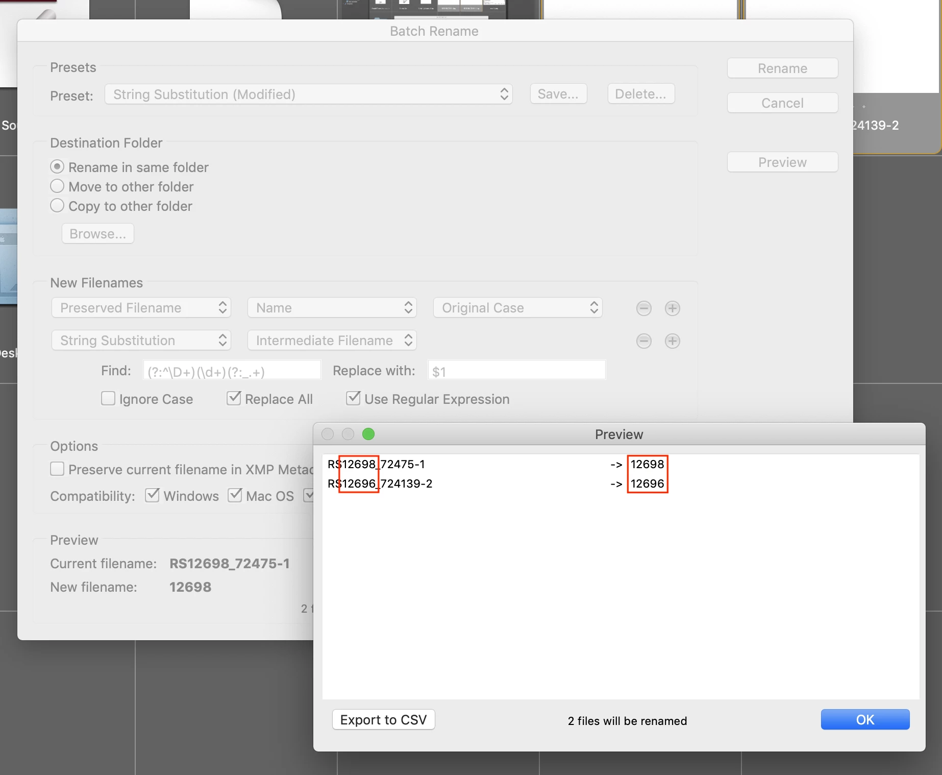

Hah, I was so focused on the regex that I missed the bit about the filename extension not being desired!
Yes, Adobe have tried to make batch rename foolproof so that one can't mess up files by unintentionally removing the filename extension... However using a 2 step rename workflow, it is possible to achieve the OP's desired result.
Step 1:
As this results in duplicates, Bridge returns the following rename result:

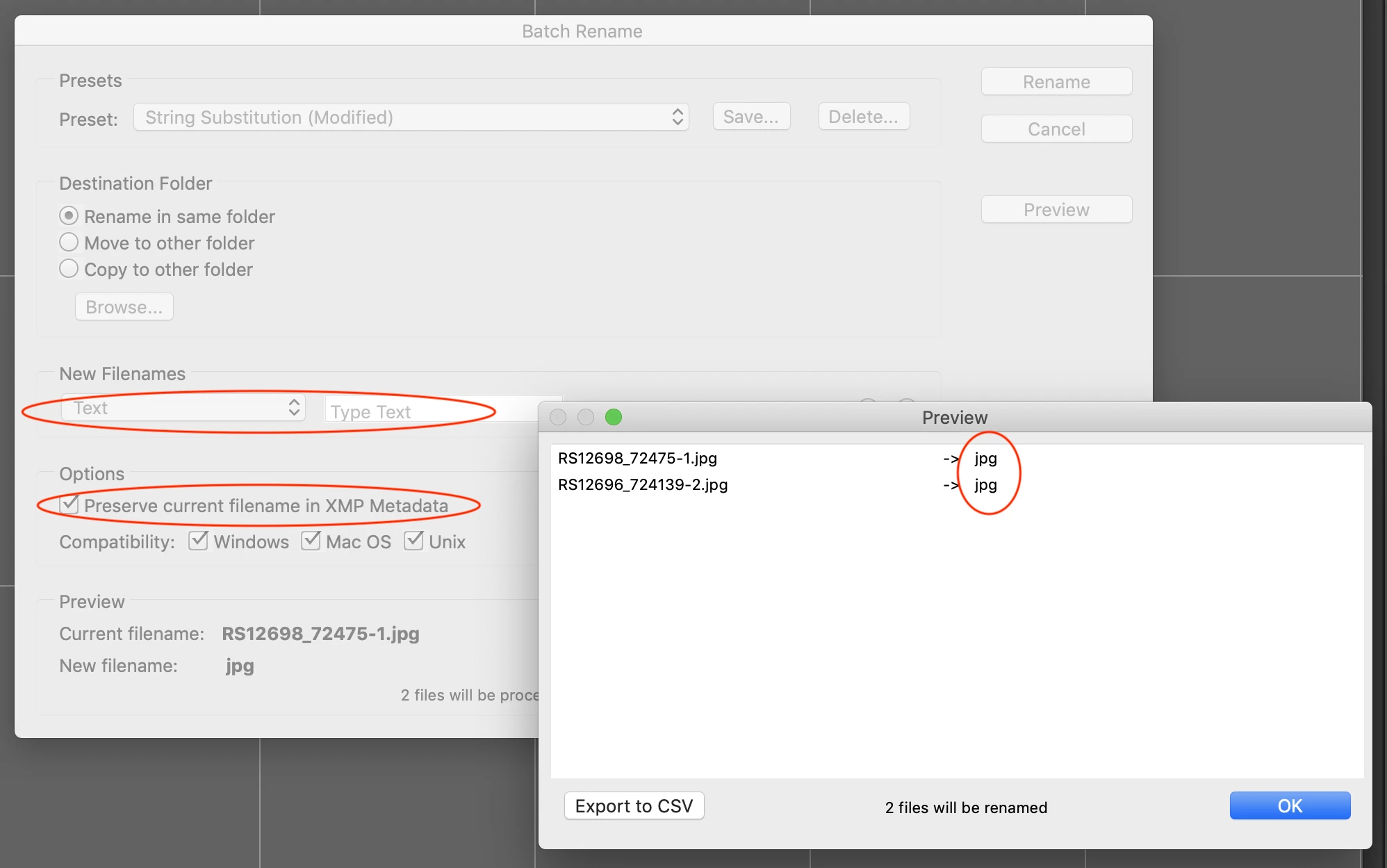

jpg
jpg (1)
Step 2:
Stephen Marsh
Jul 11, 2019 11:43 PM UTC
Here are variations on the same method for the search field (all are equivalent using groups+capture group, some are more flexible than others):
(?:^\D+)(\d+)(?:_.+)(?:\.[^\.]+$)
(?:^\D+)(\d{5,6})(?:_.+)(?:\.[^\.]+$)
(?:^[^0-9]+)(\d+)(_.+)
(?:^[a-zA-Z]+)(\d+)(?:_.+)
(?:^\D{2})(\d+)(?:_.+)
The replacement field would be:
$1
