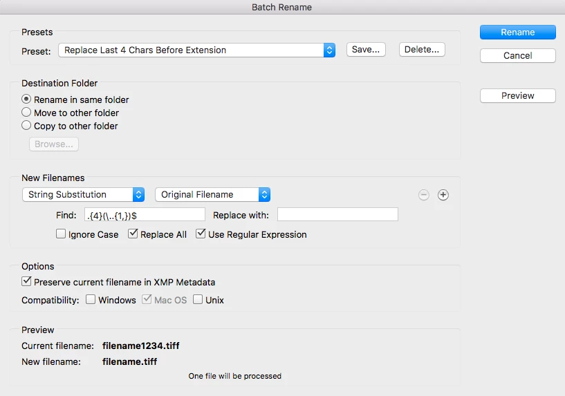

    Another viable regex alternative to the method outlined by SuperMerlin is:
    .{4}(\..{1,})$
    This valid but “less than ideal” regex works in Adobe Bridge as it has special handling of filename extensions, even though the regex is removing the last 4 characters and the filename extension, Bridge is smart enough to retain the filename extension even though it was explicitly removed by the regex. This would not work the same way in a text editor for example, as the extension would be removed.

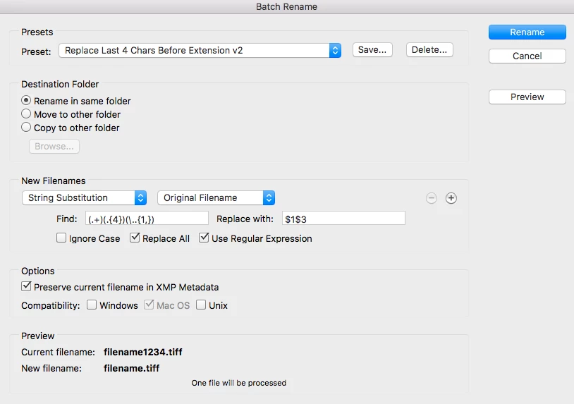

    A more robust and technically better approach would gracefully handle the filename extension (even though Bridge has a safety net with extensions)…
    Find: (.+)(.{4})(\..{1,})
    Replace: $1$3
    The $ at the end of the regex is now superfluous in this new improved regex – as the capture groups are specifying explicit positions/patterns:
    Which is a slightly different way of expressing the same regex as originally proposed by SuperMerlin, so I have come full circle with this second “refined” regex example! :]

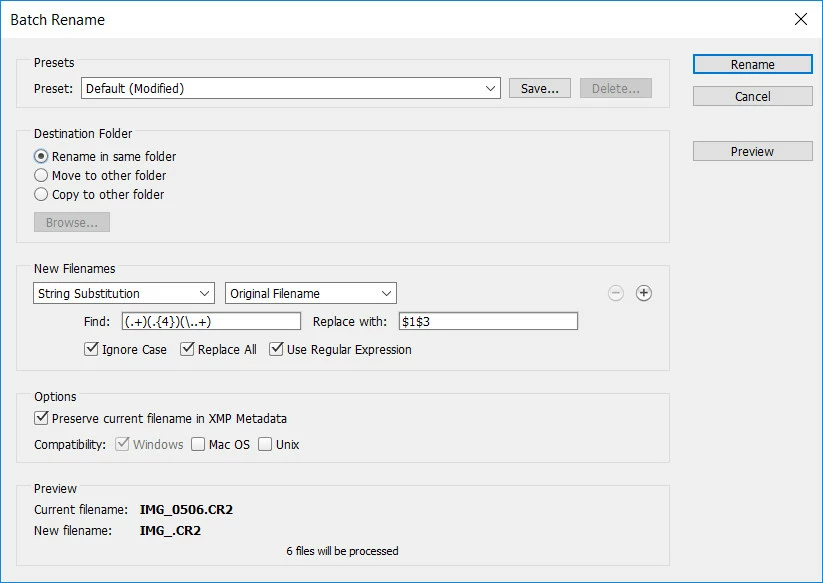

    kevinu
    kevinuAuthor
    Nov 10, 2017 12:50 AM UTC
    Perfect! Thank you so much for this detailed description. These scripts make more sense and are more manageable.
    My favorite is .{4}(\..{1,})$
    Stephen Marsh
    Nov 10, 2017 1:00 AM UTC
    Not a problem, other valid variations in Bridge also include:
    .{4}\..+$
    .{4}(\..+)$
    .{4}(?:\..+)$
    You may find the following regex testers helpful in working out what is going on:
    www.regexr.com
    www.regex101.com
