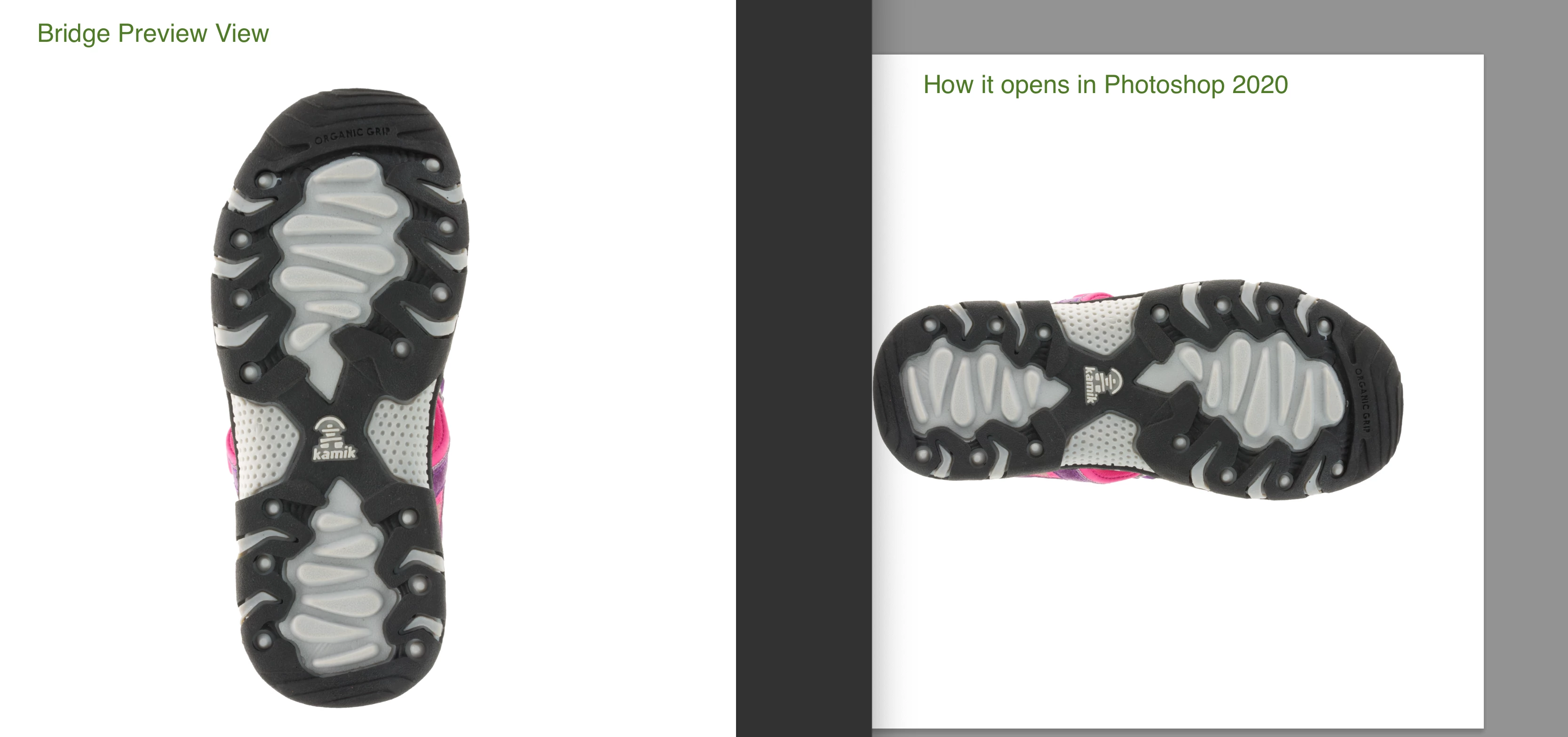

In Bridge, if I rotate the image (jpeg), it will not open rotated that way in Photoshop.  I've done this before and it's suddenly not working (likely since 2020 update).  Any suggestions?  Thanks!

Hi mrshoffu,
Well it certainly should. Have you tried rebuilding your prefereces?
Start Adobe Bridge and immediately press Ctrl+Alt+Shift (Windows) or Command+Option+Shift (Mac OS) until the Reset Settings dialog box appears. Select all three options--Reset Preferences, Reset Standard Workspaces, and Purge Entire Thumbnail Cache--and then click OK.
Let us know if that solves the issue
mrshoffuAuthor
Aug 21, 2020 5:09 PM UTC
Thanks for the quick reply.  I did as you suggested- twice- and no change.  It certainly seems to be some metadata issue and I'm just not sure of next steps.  I've adjusted my workflow, but obv to see a rotated image only to have it not actually rotated is not ideal.  Thanks!

All right, sorry that the obvious didn't work.
Care to try some more investigation?
Experiment 1: Rotate some images, close the folder and reopen the folder. What is there status?
Experiment 2: Rotate some images, Quit and reopen Bridge. What is there status?
Experiment 3: Rotate some images with the rotation icon, then do the above two experiements. What is there status?
Experiment 4: Rotate some images with key commands (Shift-Option-[ & ]), then do the above two experiements. What is there status?
What I'm trying to do is to test within Bridge if the change is only visual but the image has not really rotated or (at least) Bridge sees the images as rotated. If Bridge fails in any of these experiements, than we know that the problem is Bridge and it's not as if Bridge correctly rotated the images but PS is not reading the data correctly.
Thanks for your patience on this
