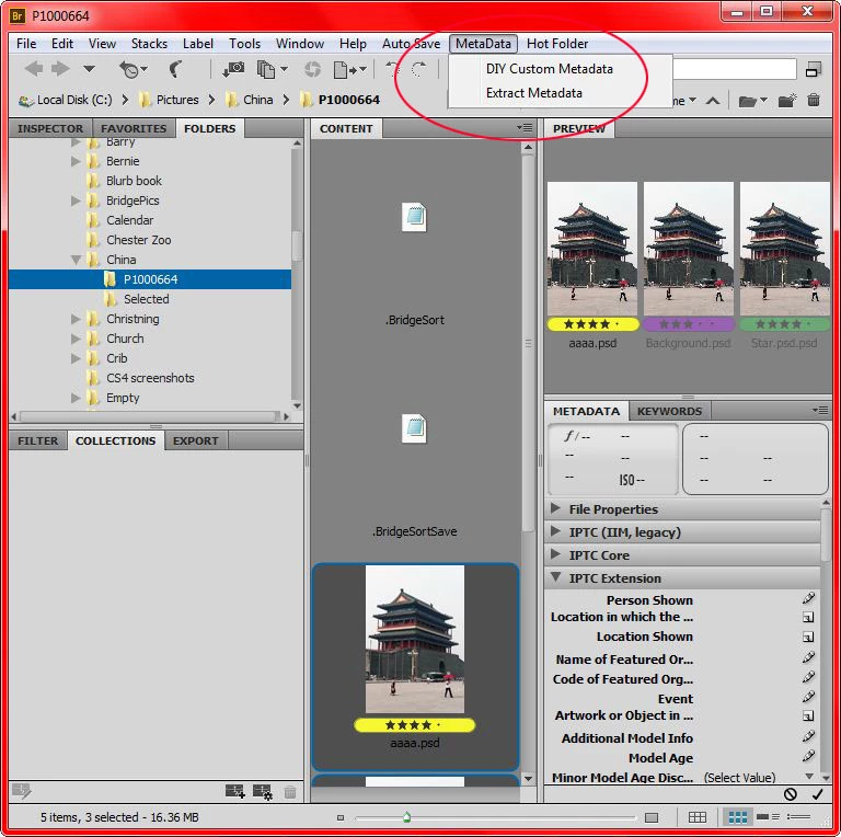

To install the script:
Download and unzip the script.
Start Bridge
Edit - Preferences -Startup Scripts
At the bottom click the "Reveal Button" this will open the folder where the script should be placed.
Close and restart Bridge.
Accept the new script.
You will then have a new Menu item..
To use select the files, Metadata - Extract Metadata
This will create a CSV file or a TAB delimited file depending on what you select and the new file will be put on the desktop.
This file can be sent to whomever you want, your files are not altered in anyway.
The second script is used by the person whom you are sending the data to want to set their files to the same as yours if that is required.
Hop this helps

If you want to create a csv file with this data you could use....
http://www.scriptsrus.talktalk.net/Extract%20Metadata.htm
Also if this data needs to be put into the remote files you can use...
http://www.scriptsrus.talktalk.net/DIYmetadata.htm

Feb 4, 2013 7:12 PM UTC
Ok, I also answered to the other questions.
I create my csv file with the first script and I load the datas on the files using the second script.
At the end I have this "Error log.txt" files with this text in it:
Processing :: C:\Users\(...).csv Total Files = 4
Is it right?
