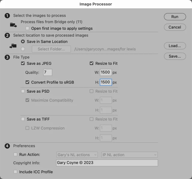

In Bridge select all of the images you wish to convert into a jpg. From the Tools (menu), go to Photoshop -> Image Processor.
Here, select what you want, and click "Run."

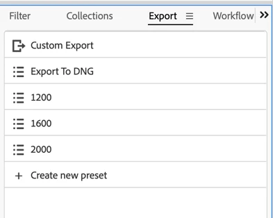

If there is a size setting that you like and use a lot, you can speed things up by going to the Export Panel and pre-create those settings. Here are some that I use often enough to have already made some presets.

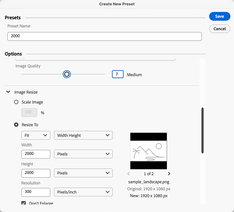

When you drag the selected images onto the preset that you want, they will all be resized. Note that the setup is a tad different than in the Image Processor (what you're seeing below is scrolled down a bit, you cannot resize this setting layout).
 Notice on the Resize to: the 2nd dropdown says "width height." This means that whichever is larger will be honored; the other dimension will be sized proportionally, like the Image Processor.

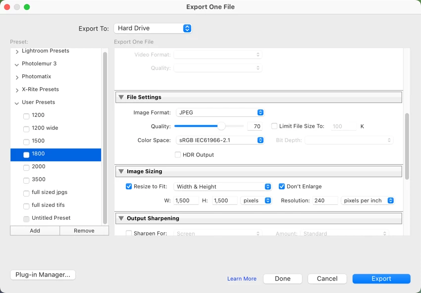

On the Lightroom Classic side, it's different but the same.

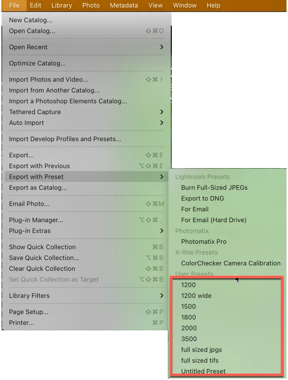

To create new presets, you do this from the File (menu) -> Export… and this brings up this window. (Again, the window doesn't resize, so I'm only showing a portion.)
You first start to create a Preset by clicking the "Add" button on the bottom right side, then you set the desired settings on the right.
 To access this, select the desired images, then go to the File (menu) -> Export with Preset and select the Preset you want.
Let me add that I always use Presets with size (longest edge). If I need to export a TIF or PNG, I'd create a new one at that time.
