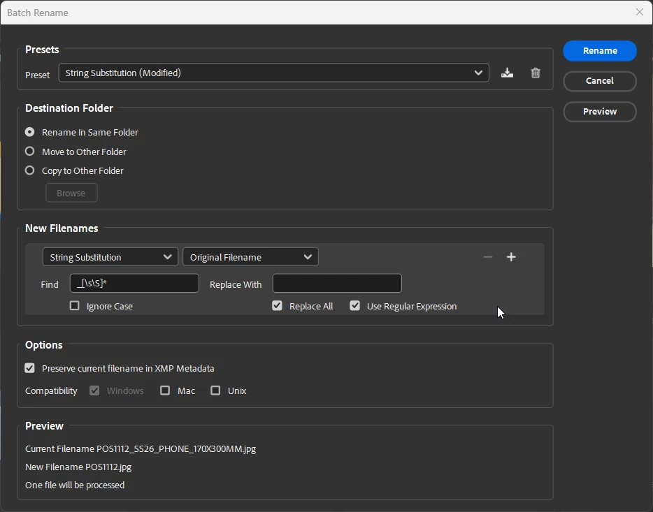

Hi! I'm trying to rename a batch of images named similar to the following:
It's a mix of JPGs and tiffs but they all follow the same layout as above. I only want to remove everything after the first underscore to leave them as-
  • POS1112
  • POS1118
I'm aware of regex but sadly don't have a clue where to start with it.
Thanks in advance!
Stephen Marsh
Stephen MarshCorrect answer
Sep 25, 2025 11:33 AM UTC
Option 1: Find, Replace with nothing -
_[\s\S]*
Option 2: Capture group find/replace -
^(.*?)_.*
$1
Stephen Marsh
Stephen MarshCommunity ExpertCorrect answer
_[\s\S]*
^(.*?)_.*
$1
Sep 25, 2025 12:06 PM UTC
Worked! Thank you!
