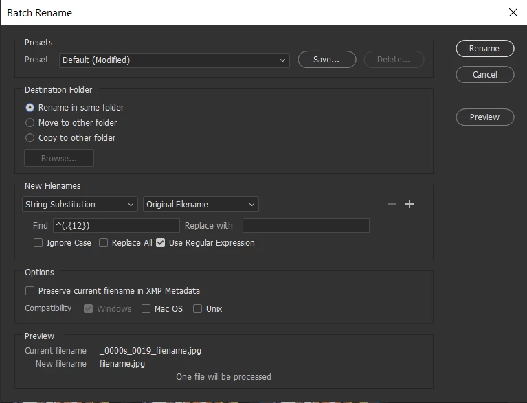

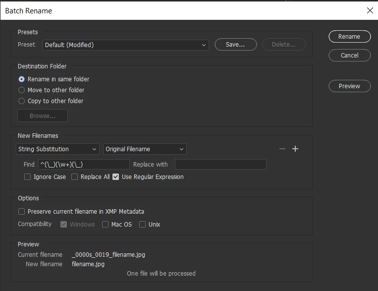

I have a similar issue but I don't understand the find functions. The Photoshop export layers to files function add a load of unwanted prefix numbering to the files.
Do you know what string substitution I should need to use to remove a sequence like so:
I can remove _0000s_00 by simply adding that, but how do I do the entire sequences between the underscores in one clean sweep?
It would save me a lot of messing about.
Thanks
Will
I can't see your full file names, but I think this will do what you want:
Find: ^(\_)(\w+)(\_)
Replace: blank
Another approach: if you want to remove the same number of characters from the beginning of all the file names (in your case, 12), you could do this:
Find: ^(.{12})
Replace: blank

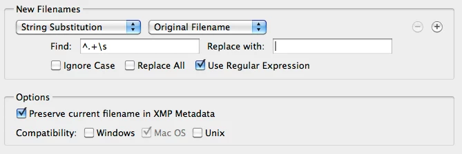

Have you looked at using Bridge's batch rename…? It now has regexp & string subbing… You also have the opportuinity to store previous name in file XMP when renaming…

Well this could be done with script or the built-in Batch Rename function… Much depends on where all these files are?
This should give you what you want… ^ matches beginning of line . the dot matches any character the + makes the dot greedy then \s matches space… Replace with nothing… Hope that makes sence…?
