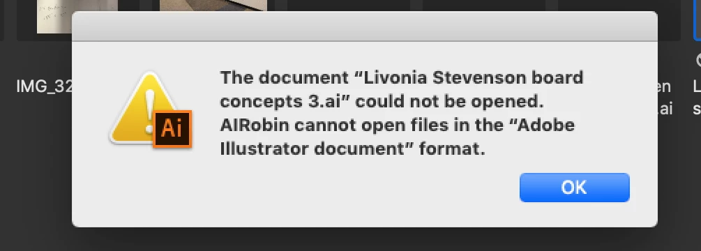

Suddenly Adobe Bridge suddenly wont open my illustrator files
Adobe Bridge suddenly wont open my illustrator files. I have latest illustrator and bridge. I can open the files through illustrator but not through Bridge.
Getting the message
The document....could not be opened. AlRobin cannot open files in the 'Adobe Illustrator Document' format.
Thnaks for your insight!

I guess basically you have to go into Bridge prefrences/FileType Associations and manually set each file type to open in the application of your choice. I don't have Acrobat or Photoshop since Adobe started charging extra for them, but have set my files I use to open in illustrator 20. The 'open in' feature no longer works though.
Dec 11, 2019 4:12 PM UTC
The File association for .ai Seems to have fixed the problem for me.
thank you.
What was odd, is that it was defaulted to this Robin thing... where did that come from?
