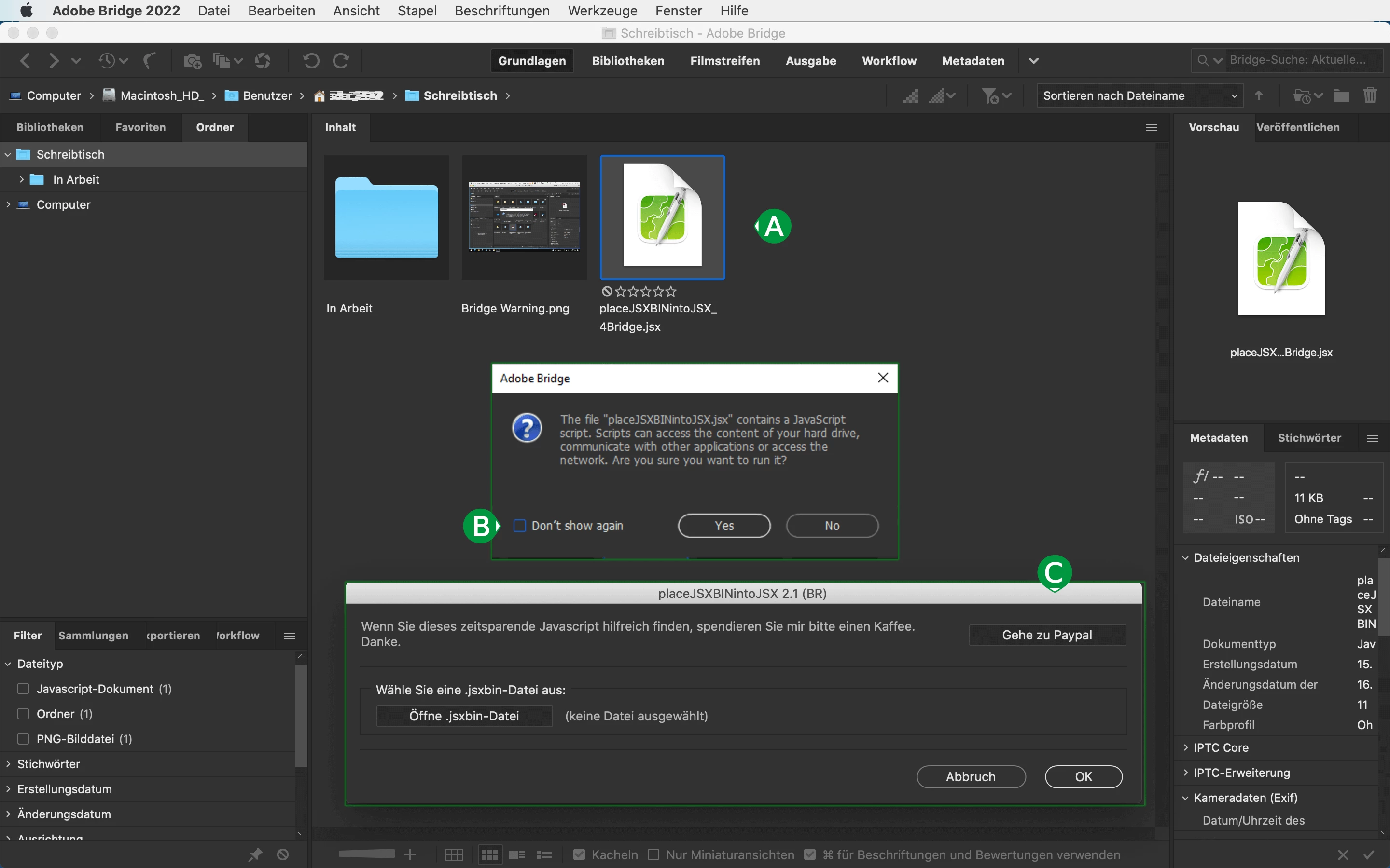

Parts4Arts
Jan 17, 2022 5:58 PM UTC
Just a simple example
#target bridge
alert("Hello world!");
I start the .jsx file by double click in adobe bridge (A),
I get the warning (B) and than I see the jsx running (C).
(Screenshot from a other project.)
Jan 17, 2022 9:00 PM UTC
Don't do that.
You can load your script in the Bridge Startup Scripts folder or one of the Adobe folders that all CC apps look in.
