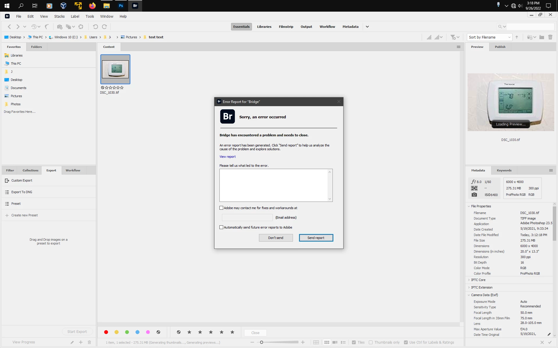

I've now done this on my desktop and laptop which both run the same versions of PS and BR and Bridge 2022 will crash on both when doing the following:
  1. Save an image with a text layer as a TIFF in a folder.
  2. Access the folder with Bridge and Bridge will crash.
  3. Save an image with a text layer as a PSD in a folder.
  4. Bridge behaves normally.
Bridge 2022 will also not crash when browsing similar TIFFs created using Photoshop CS6.
Can someone else confirm this behaviour?

I have the same issue. running Bridge 12.0.3.270, supposedly the latest, still the same. My CC app shows I have both 12.03 and 13 installed, but when I open 13 from the CC app it shows as 12.0.3.270.
I unistalled 12.0.3 and I have Bridge 13.0.0.562. It now works, does not crash with tif files with text layer.

Thank you for the suggestion. I installed Bridge 13 (Beta) and the results are interesting.
Bridge 13 (Beta) does not crash when accessing the folder with a "Tiff w/Text layer".
I then tried again with Bridge 12.0.3 and it no longer crashes when accessing that same folder. Interesting indeed ...
I then uninstalled Bridge (Beta) and Bridge 12.0.3 still works fine when accessing the folder with a "Tiff w/Text layer".
I'm wondering if Bridge (Beta) replaces/updates a file that's common to both versions (a DLL?) that's defective in the Bridge 12.0.3 install?
Thank you PECourtejoie. Your suggestion resulted in an unexpected fix. I'll try it on another computer to see if it works there as well.
(BTW: The Bata seems to have other bugs that make it unusable, so I'll stick with 12.0.3)

In my tests it seems to require only a background layer PLUS one text layer. Adding additional layers seems to not affect the result.
I suspect it's being caused by the way Bridge v12.0.3 is interacting with the new Unified Text Engine which was a change made in Photoshop 23.0 (October 2021 release). A folder with older (pre-Photoshop 23) TIFF's with text layers works fine with Bridge v12.0.3.
Changing preview options in Bridge v12.0.3 mades no difference.
Changing from an OpenType typeface (Arial) to a TrueType one mades no difference.
Running Bridge v12.0.3 in Administrator mades no difference.

Without installing v12.0.3 you'll be unable to experience the bug. All compression options have been tested as well as enabling/disabling ACR TIFF support. You can create any TIFF you want w/ a text layer yourself to test with. It's not specific to anyone's 'special' file.

Yes i can replicate this on the windows side, but not on the mac side.

Using Bridge to access a folder with a Photoshop created Tiff that has a text layer causes Bridge to immediatly crash.
