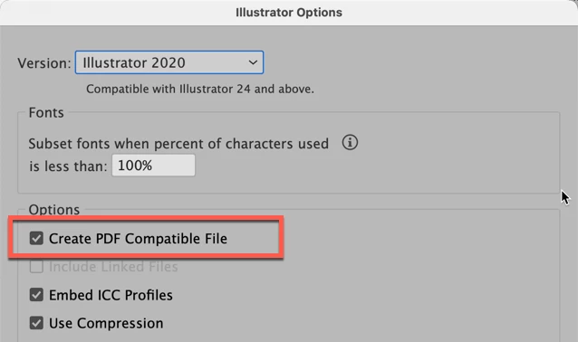

Now, with the Illustrator files: two-part answer. Some Illustrator files do not show up, I'm not sure why. All of mine do but others, not so much.
One posibility is that when they saved them, they did not turn on the option to also have a PDF compatible file (see below)
If I recall correctly, if you do not have this checked, it will not show up in Bridge. If you do not have it checked, it WILL NOT show up when tap the Space Bar on the Mac. In Bridge, currently, if you not have this checked, the file that shows up will be smaller.
However, if you do check this option, the file size may be larger.
I hope this all helps.
