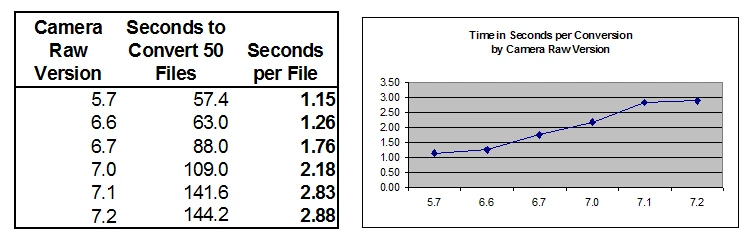

    2. How quickly Camera Raw actually converts (multiple) raw files to images.

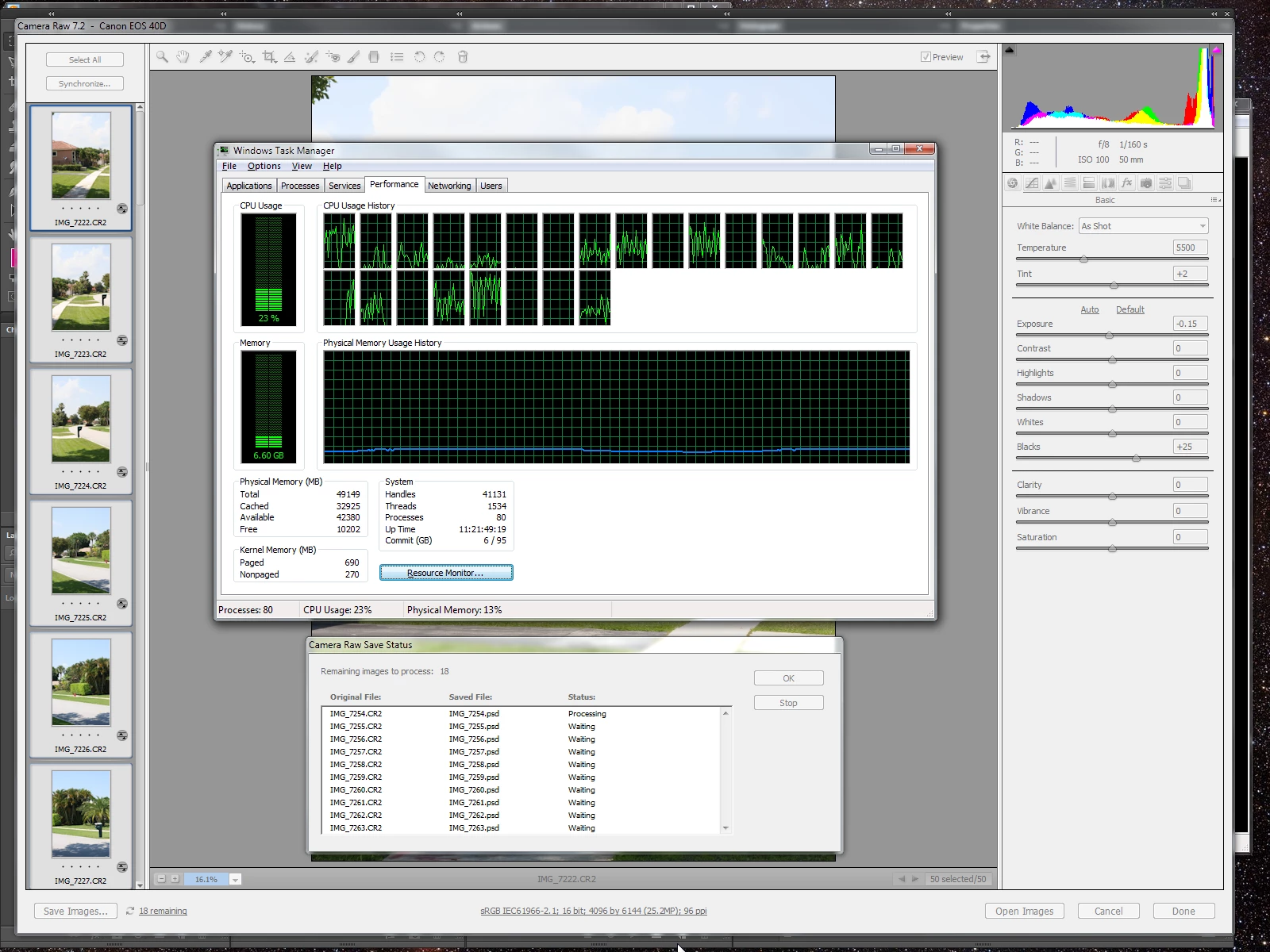

      Based on my measurements on a multi-core machine, some aspects of interactive performance have been improved in version 7.2.  But for doing blocks of multiple raw conversions this is pretty much the slowest version yet.  But that's somewhat understandable - people always want more functionality, and assuming that takes extra code (not a bad assumption, as past versions were already heavily optimized) then that will come at a cost in speed.  But is it reasonable?
      Here are my results of doing blocks of conversions with multiple different versions of Camera Raw to test the throughput.  I converted the same set of 50 raw files to 6144 x 4096 pixel .PSD files, striving to keep the output as much the same as possible between versions of Camera Raw.  All tests were done with 64 bit Camera Raw on Windows 7 x64 with the same reasonably modern 12 core machine.  You can easily see the progression of ever slower performance:
    -Noel
    Noel Carboni
    October 4, 2012

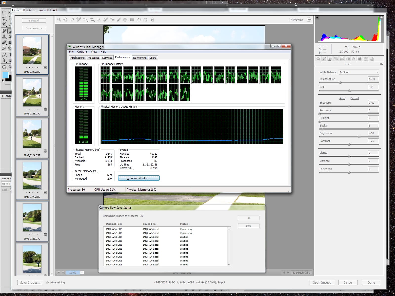

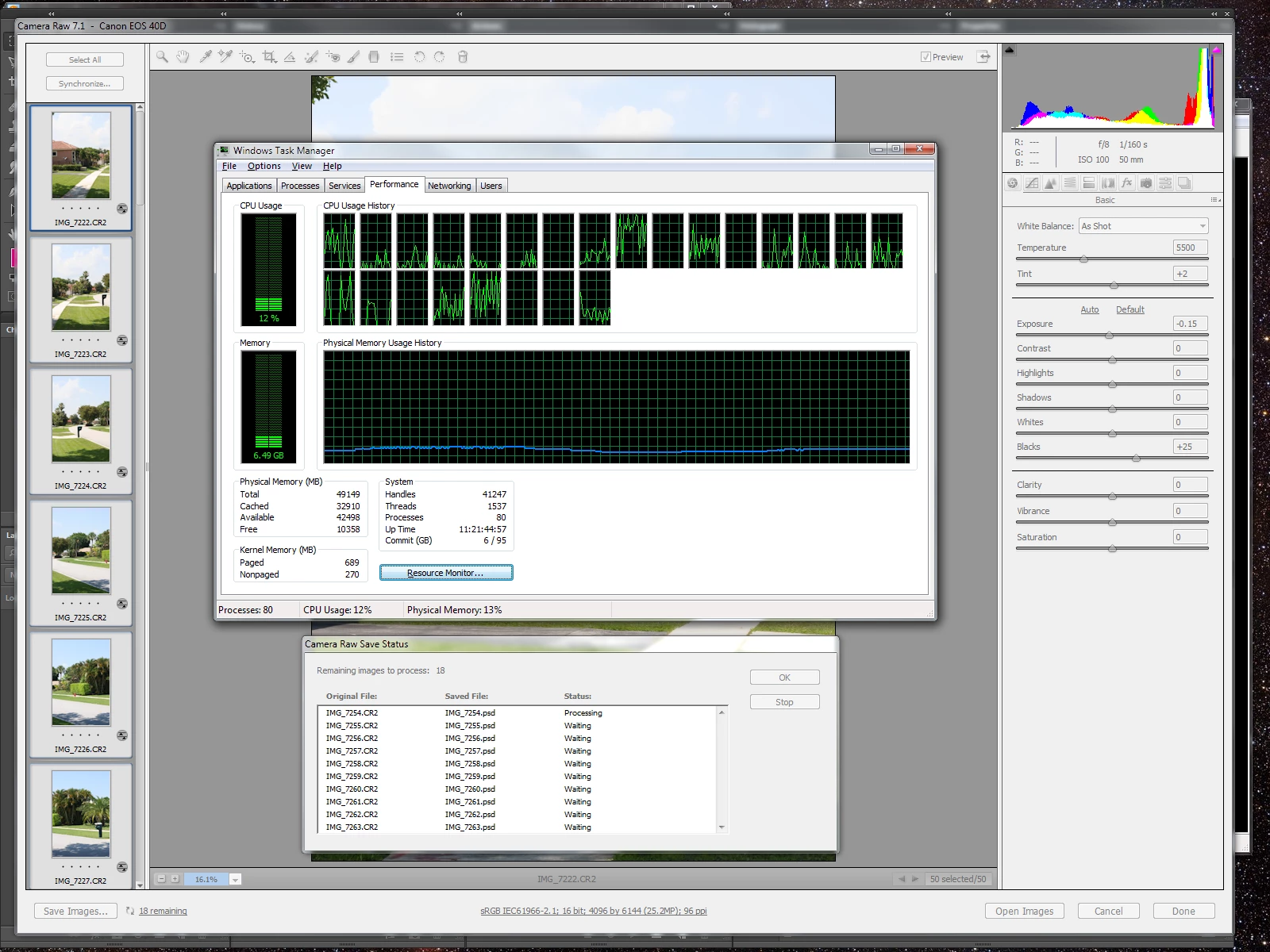

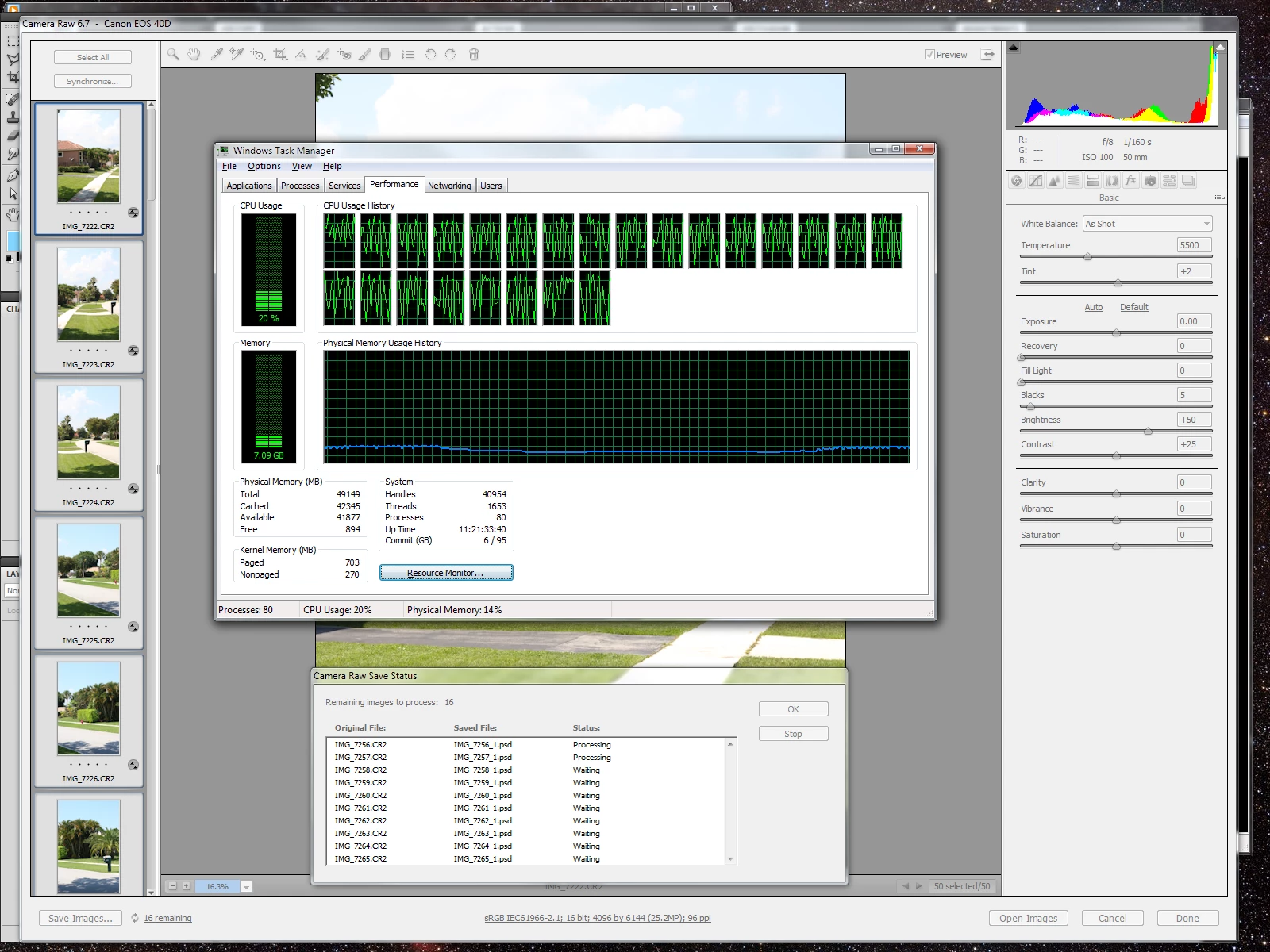

    These will give you a visual idea how the various versions multi-thread (yeah, I know, quite likely more detail than you wanted to know).
    -Noel
