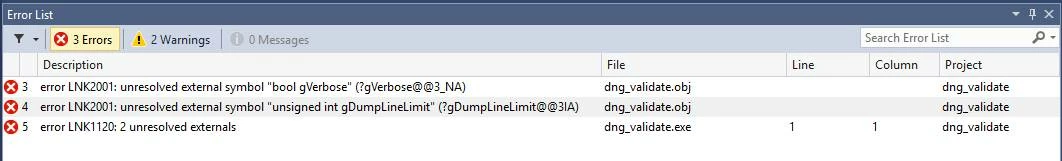

Please bear with me, as I'm just learning visual basic. I'm at the initial stages of checking that the SDK is installed correctly, but when I build dng_validate, I am stuck with two unresolved external symbols: gVerbose, and gDumpLineLimit

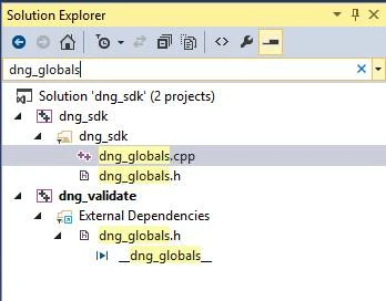

sandy_mc​
Thanks so much for your reply.
dng_globals.cpp is part of the dng_sdk. Is there something I need to do to have dng_validate recognize this?
Here's a screenshot of the solution explorer (VS2013):
And the errors after building/debugging:
Any clues what could be going wrong?

November 22, 2017
Well, your solution explorer screenshot can't possibly compile - it's missing a vast number of files in the dng_sdk section, unless the SDK is being included somewhere else. I'd suggest using the project file supplied with the SDK.
