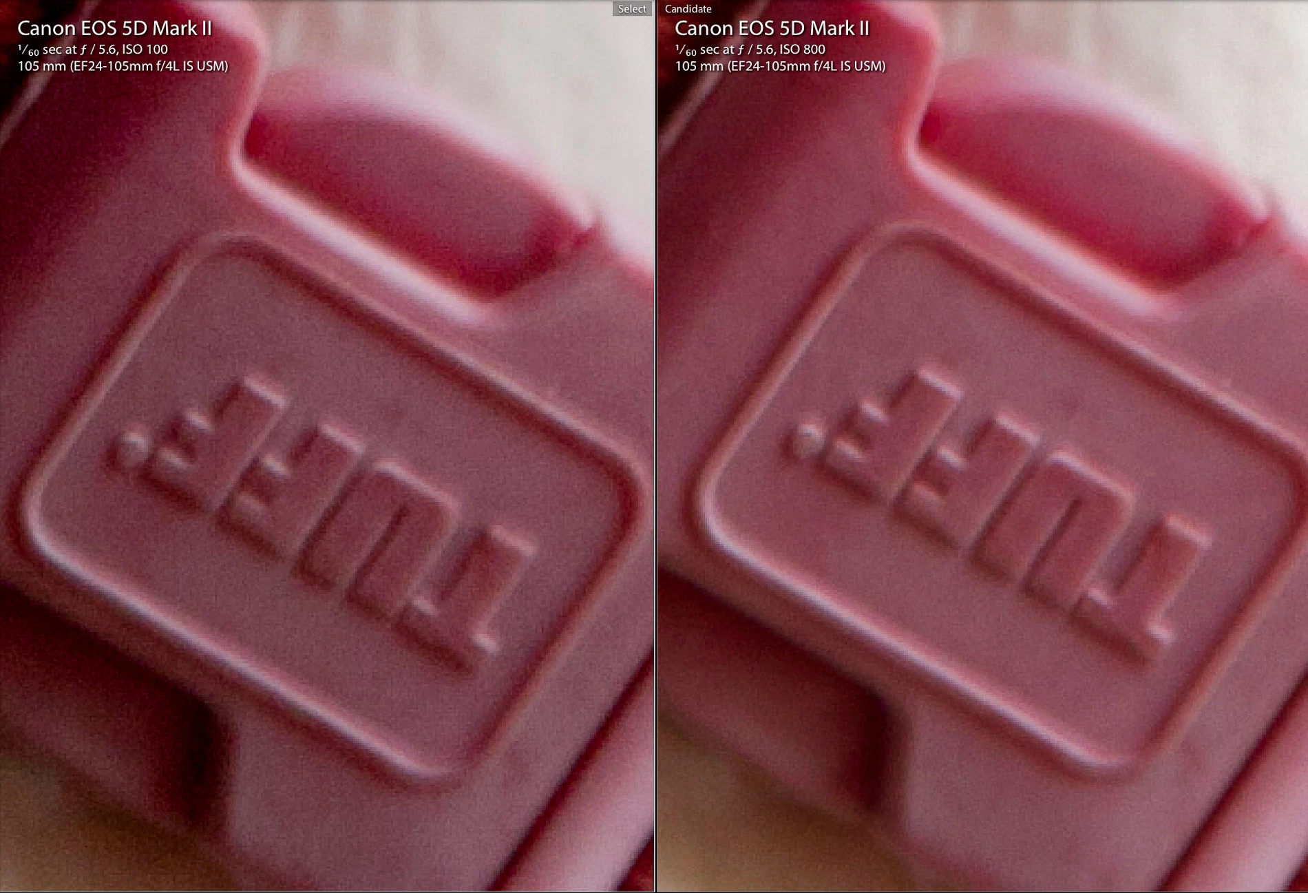

So now the issue becomes, Noise Reduction in two differing products. We can go there if you want; look at the NR options in Adobe Camera Raw that might help get it closer or better than C1. But the noise isn't due to Adobe Camera Raw or low ISO. ISO has no (direct) effect on exposure. Exposure is only two attributes that control how much light strikes the sensor: Aperture and Shutter. Auto exposure can cause underexposure which is what we see here, and that's why the image is noisy.
A lower ISO can produce far more noise than a higher ISO:
So again: now the issue becomes, Noise Reduction in two different products, and maybe you want to try the new Denoise features in Adobe Camera Raw.
