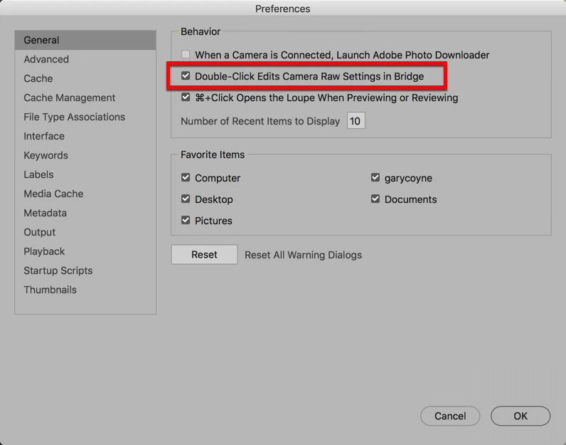

Well here's the deal: you are either going to tie up Bridge or you will tie up Photoshop. It sounds like you're prefer to NOT tie up Bridge and this can be done.
Go into Bridge's Preferences and in the General tab there's an option marked out below. If you uncheck that than ACP will open and occupy Photoshop's brain instead of Bridge's brain. This means that you can load up a whole bunch of operations in ACR and still have access to Bridge.
HOWEVER: this only works on double-clicking an image. If you right-click an image (or click on the ACR icon in the Tools region) this will cause ACR to act like it's taken over Bridge's brain again. This furthermore means that if you are opening up JPGs or TIF images for the first time (and thereby right-clicking), it will not work. If you have already made ACR adjustments with ACR and are re-opening the same document, than you can double-click with impunity while leaving Bridge available.
Please let us know if this was what you are looking for.

Thanks Gary, that's helpful.  Unfortunately I wasn't clear enough in my question, what I want to close ACR so that I can select a new folder of images to work on using Bridge without waiting 10-20 minutes for ACR to update settings from the last batch.  That is, somehow put the file saving part in the background, or if not then open a second ACR window to ignore the one saving settings.  So I only use Bridge to select photos for ACR, so when ACR is stuck saving having a usable Bridge window do me any good, because its another ACR window that I need.  Thanks, Matt
