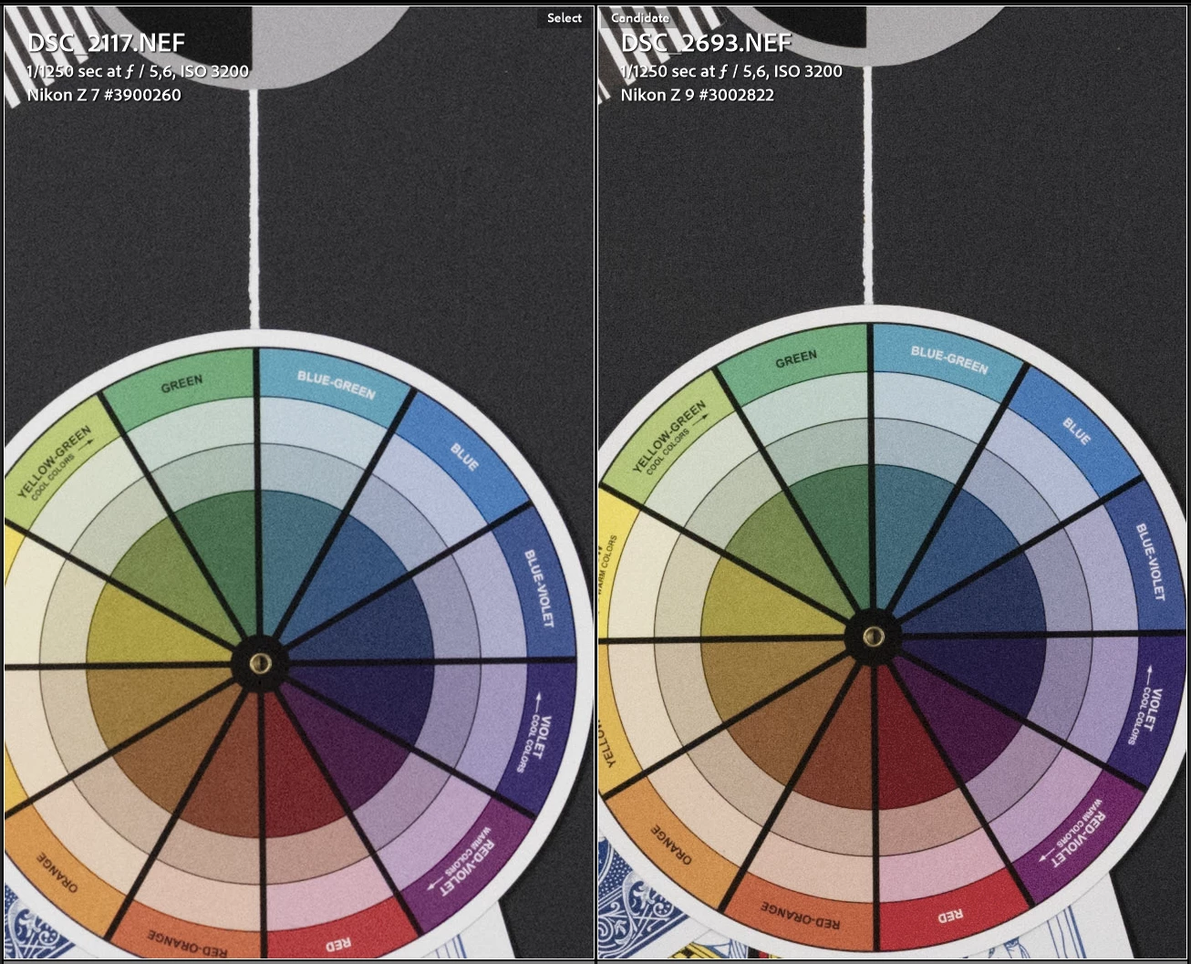

There have been several posts by Z9 users complaining about high noise  levels with this camera.
Some of them have provided raw files, which have either been correctly exposed, with what I consider perfectly normal noise levels when viewed at 100%, or moderately to badly underexposed, which inevitably leads to increased noise when the Exposure and/or Shadows slider is dragged to the right.
Since you think that the Z9 performs  worse than the Z7, I download test files from both cameras from DPreview shot at ISO 3200 to see for myself. I imported them in Lightroom Classic, set sharpening to 0, used no Luminance noise reduction, and left Color noise reduction at the default 25. To get a closer tonal match, I made some minor tweaks to Exposure,  Shadows and Highlights on the Z9 file.
When compared at 100%, the most striking difference is that the Z9 file is sharper.
It also appears to be a tiny bit noisier in some areas, and I think this is because of the sharper sensor.
I'd say the difference in noise is marginal.
Below is a screenshot at 100%. Make sure to view at 100% as well.
