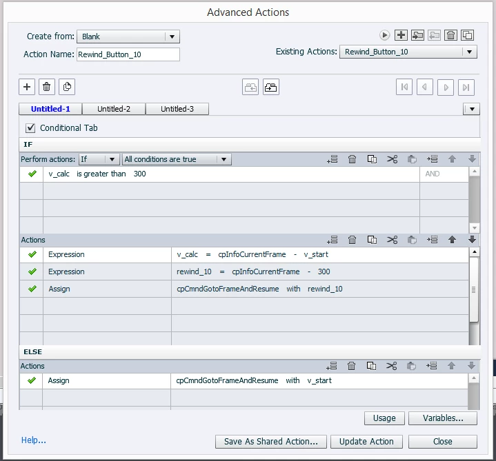

nickcbAuthor
Jul 30, 2018 6:29 PM UTC
Thanks.
I've got this set up as below. and then to capture v_start I have the slide action "On Enter" with the Assign and Continue you provided above.
I'm not familiar with conditional actions, and using expressions - but something needs to be re-configured in the rewind action though, as it's restarting the slide. I'm not sure where to define the v_calc variable before the IF condition is run.  Can you help?
Will we have to change the On Enter action for every slide to capture v_start, or is there a way to do it globally? or as part of the rewind action?
Thanks
Lilybiri
Jul 30, 2018 6:58 PM UTC
You need a normal decision before the conditional decision because you have first to calculate v_calc before you can use it in a condition.
