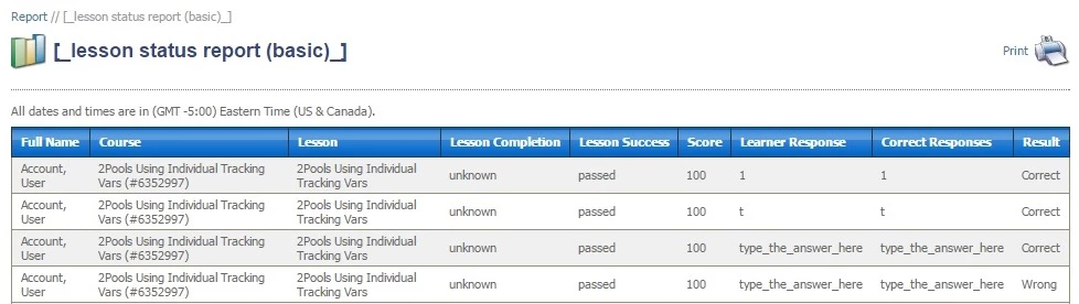

I have uploaded to Inquisiq, which is SCORM 1.2.  I’m able to see responses for individual questions and if it was correct or not, screenshot attached.
