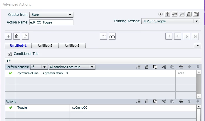

Hey Sharon, I checked your question earlier but didn't really gave a thought. Sorry about that.
Now, I am not into JS developer but I just read your original question a bit carefully and tried to get it work using Advance Actions. Answer to your question
The problem is that I want the captions to start automatically when the audio on the timeline plays. Right now the captions start when a new slide loads.  Sometimes, however, our audio doesn't start immediately, so everything gets out of sync.
could be here in screenshot below. it worked for me, let me know if I get it correctly. Or may be I didn't get your question and you don't want to use advance actions.
I have applied the action below on enter while keeping the default CC disabled:
Check the preview for the same project.
